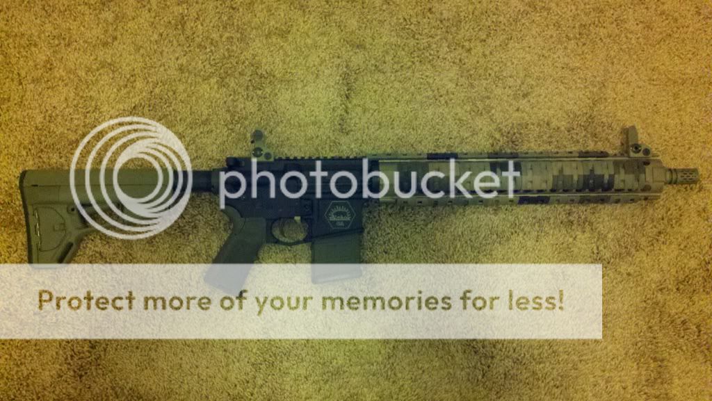

I'm tossing around the idea of putting a long rail on my norinco...
I'd like it to look something like this:
What kind of rail would I be looking at? Where would I buy it? How much?
Would I need to remove my frontsight and replace the gas block? I've hear about people chopping the sight off their original gasblock, but don't know if that'd be low enough? Plus, I think i'd like to go adjustable anyway...
Look at a 14" rail. One Shot will get Daniel Defense. You can also try a 13" Troy TRX standard or TRX 13.8" Extreme (pm cqbservices).
You need to remove the front sight. You can get a low profile gas block or just modify the original. It usually does work great but it depends on the rail. I know Troy rails can be done.
To install such a rail you need to remove the delta ring assembly and the front sight.
Good luck.
