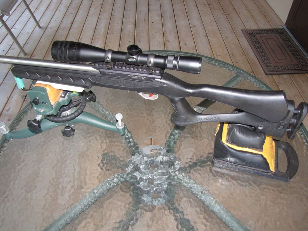

I have had good results with my Tactical Innovations receiver & their matched bolt. Kidd 18" SS barrel & Kidd two stage trigger. This is in an Archangel target stock. Scope is a Weaver V24 in Burris rings with offset inserts +20 in the rear & -20 in the front.
Here's a pic of the rifle.
The Ruger 1022 is the AR15 of the .22 world. More upgrade parts are available for this than any other semi-auto .22 rifle. Go online to explore what's available. As for a scope, get a good quality centre fire target scope with plenty of elevation adjustment. Don't skimp on a scope if you're serious about target shooting. Rob B has a nice setup but I would pick a variable power scope. This allows you to shoot from about 25y and up. A 24X scope is a bit much at short ranges. A good .22 forum to get info is: http://www.rimfirecentral.com/forums/
The V24 is a variable scope, 6 - 24 power. I believe you are confusing the V 24 with the T24.[/QUOTE]
Ooops, sorry about that. I did confuse it with the T24.
