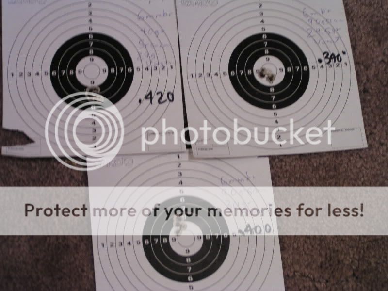

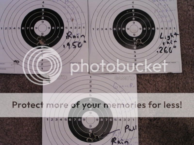

How many of you have shot groups in the rain? I was testing a new rifle this morning, and I started shooting before the rain began, and continued to shoot during the rain. I managed to shoot three five shot groups out of my new to me 6mmbr with the 90gr scenar, which measured .340",.400", and .420". Then it started to rain, and I decided to shoot my groups anyway. The first group with the 95gr Matchking went into .260" in the light drizzle. The rain picked up, and the next group measured .440", with the following group also in the rain at .450". I should mention that since I was working up loads, I was using three different powder charges for each bullet, so that could also be a factor.
Another interesting observation, was that with each 1/2 grain increase in powder charge, the point of impact with the 90gr Scenar rose about 1/2". However, with the 95gr Matchking, the point of impact remained constant, with all 15 shots going into about .550".

The 95gr Matchking groups. I laid each one on a clean target, and marked the holes on that same target, as best as I could. The end result measured .580". The black ink covered the edges of the holes, so they aren't as easy to make out now.
And the 90gr Scenar groups. The change in point of impact with powder charge is easy to see.
