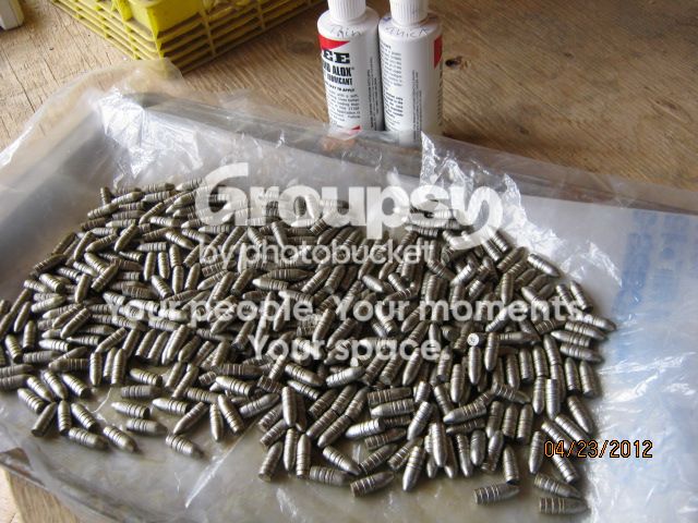

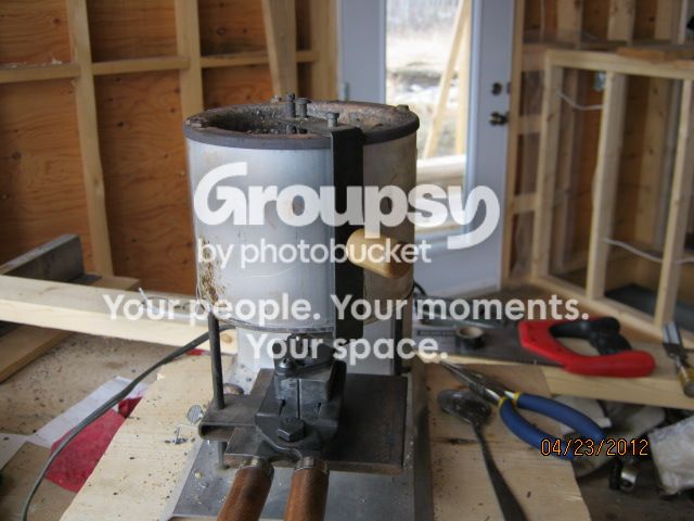

The lead melting pot, it takes 20 lbs of lead. I added 6 lbs while casting.
The bullet is a 160 grain .309 cal that takes a gas check.

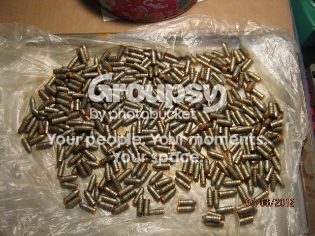

This is a thinned down, light coat of Lee liquid Alox. The resizing and gas checking is done in the same operation. It will be sized to .309.
After resizing it will get a slightly heavier coat of Lee liquid Alox. I will launch these puppies out to 1000 yards soon.

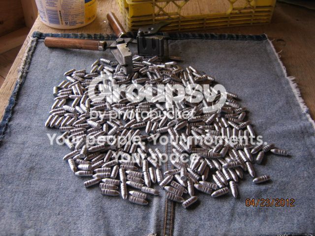

I have the 308 cal molds for 150g fp, 160g rn, 170g fp, 180g rn and 200g rn.
It is always a great day to cast. What rifle/caliber you shooting those in? My 30-06 and 30-30 love the same bullet or the lyman 311041 sized to .311 for best accuracy.
The 150 and 170 grain flat point are for the winchester 30/30. The 3 others round nose are for the Savage model 12 F/TR 308. I hope to get some decent accuracy with them, but we will see. I also have a Savage 116 weather warrior that I will try them in it as well.
IMR 4064 will be the go to powder. I'll start with a ladder test and see how it goes.
Nothing like sending your own bullets down range. Need some dragon bullet lube now.
