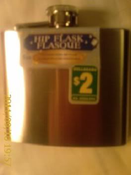

That was a really good idea. Didn't have to go far to find one, either.
Dollarama store, 5 oz. stainless steel flask, $2.00
Got the last one they had. :D

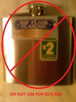

UPDATE 09-18-2011:
THE CHINESE "STAINLESS STEEL" FLASKS LEAK THROUGH THE LETTERING STAMPED ON THE BOTTOM!!
After mixing up my fresh batch of Ed's Red, I filled the flask with 5 oz of Ed's Red and set it on the bench while I capped and put away the larger storage container.
When I lifted the flask up, I found a puddle of Ed's Red underneath. Thinking I must have spilled, I thoroughly wiped down
the flask and cleaned the bench surface. I then placed the flask on a sheet of plain white paper.
I lifted the flask 30 seconds later and could read (very fuzzy and runny but readable, & reversed) "Made In China. Stainless Steel 5 oz." on the white paper.
I repeated this experiment a couple more times, each time ensuring that the outside of the container was wiped absolutely clean of Ed's Red. Each time I found a pool of solvent underneath the flask when I lifted it.
I put the flask upright in a shallow, solvent proof dish and left it. Within 2 hours over half the contents had drained out, presumably through microscopic holes in the stamped letters, since I had closely inspected the flask with a large magnifier and found no pores or open welds.
A warning to those of you who might plan on trying one of these flasks for solvent.
As OldStarfire said, it'll have to be permanently and prominently marked as containing cleaning solvent, not booze.
