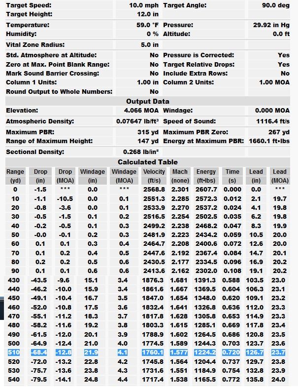

I plugged in what was at the top there, didnt double check anything so I could be off but i came up with this:
I am not familiar with this ballistic calculator, but looks close to what Ghandi had. what did i do wrong here?
edit: because 470m would be around 513 yards. sorry for confusion.
