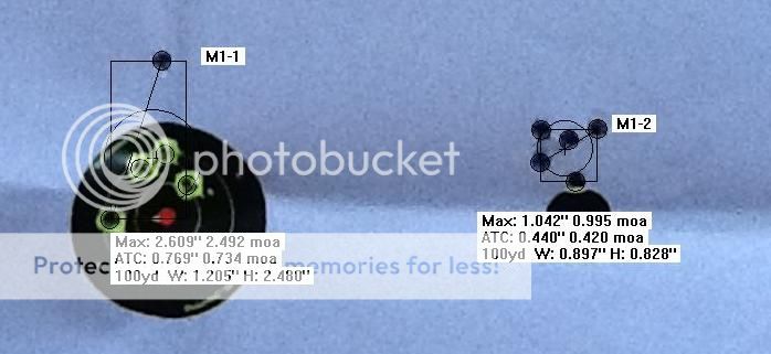

Although I am still having difficulty adjusting for first round flyers, in between a 1.5" and 2.9" group snuck in this little nugget - my best to date

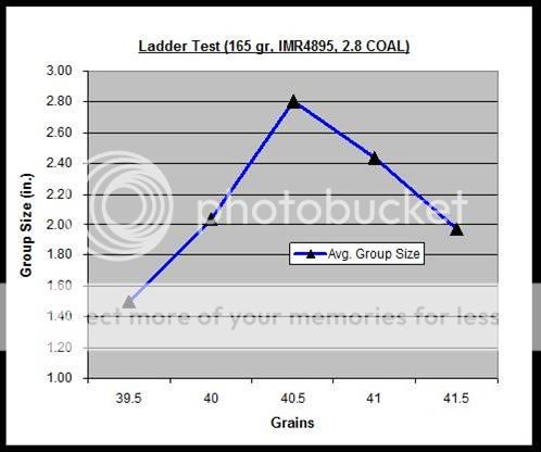

So on to the ladder test using cheap 165 grain Hornady Interbond over IMR4895, in CBC brass/primers. I had started at 39.5 grains, adding 0.5 grain increments in batches of 15-20 rounds each (i.e. enough for 3-4, 5-round groups at each loading) and stopping at a conservative 41.5 grains (reloading books show such a huge variation in max loads). First round flyers are a huge pain as I was holding POA constant to see if the load would help with flyers, which it does not.
See my results below. These aren't statistically significant due to the small samples but what is interesting is that the rifle seems to have a negative accuracy node at 40.5 grains - hates it for some reason and many others claim great results at this loading. I think I'm going to try some heavier loads since the brass is still showing no pressure signs and the rifle is functioning perfectly.

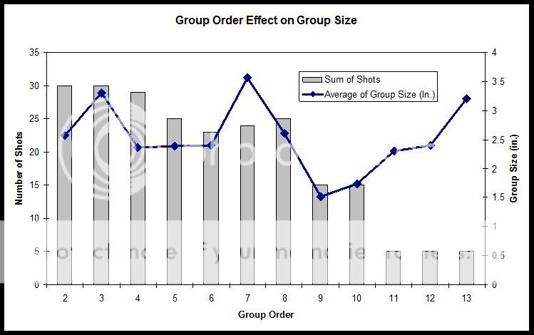

I think its interesting that I'm getting the best accuracy from lighter loads with both 150-ish grain bullets and with the 165's. Flyers are still the bane of my existence and while the worst flyers seem to have been culled by warming up the barrel with a string of Norinco before shooting for effect, I still get inconsistent groupings. Mediocre 2-3 inch groups often are tight 4-round packets and one flyer.
These groups are from the 39.5 grain series.
