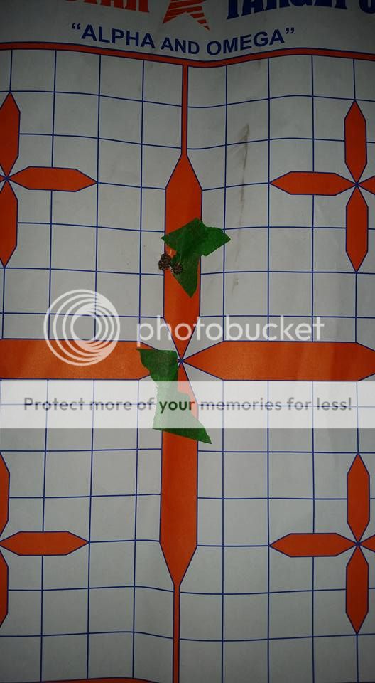

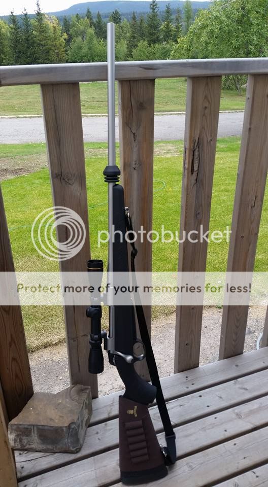

So I started the day with my Sako A7 in 300 Win. Mag topped with a Leupold VX1 4x12-40LR... this is what she did.

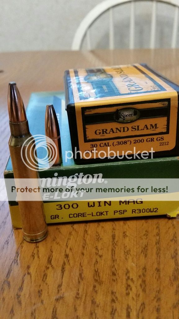

I used a load of 73gr R22, Fed 215LRM primers, Hornady cases and 200gr Speer Grand Slams. All I could manage were 3"-4"- 3 shot groups. Here's the kicker...the groups jumped all over the paper.

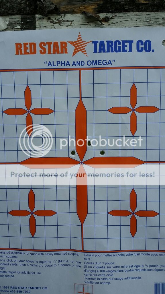

Gun went from 3"-4" groups @ 100 meters to get this...3 shots with a 200gr Speer Grand Slam over 73gr R22 @ 2872 fps to ..... 3 shot 3/8" @ 100 meters!!! (centre to centre)
I was losing faith in this gun but after a simple fix its unreal. Large group is before fix, the best I could get...the last group was after the simple fix. Its literally a tack driver now. It finally gets its accuracy guarantee Sako promises.
