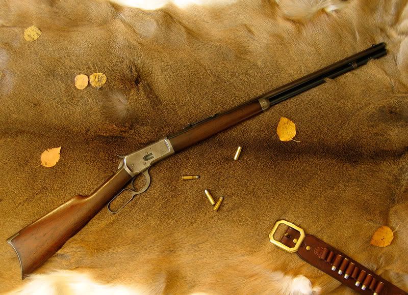

Here's a photo of my old 96-year old 38-40 ....
First off, I tapped the rear sight over a tad, since previous trips to the range showed that it was hitting a bit to the left. To see if I'd adjusted properly, I set up a target at 50 yards and I fired off two rounds that had not been neck sized at all. The bullets were loose in the neck and held in by the crimp. I didn't want to use these in my official test, so I used them as sighters. The two bullets were very close to dead center laterally so I set up a target at 100 yards. Interestingly, the two bullets that were loose in the necks gave me exactly 100 fps more velocity than the same 15 grain load did when I sized the neck halfway down to the shoulder.
