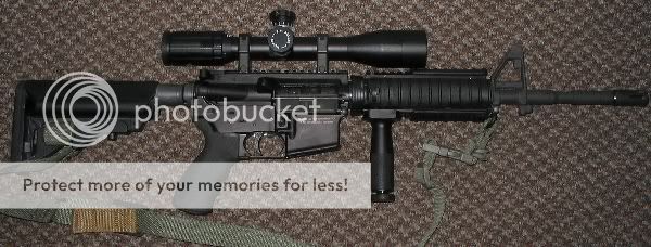

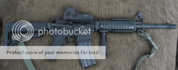

I've been shooting my LMT for a few months now. Over 400 rounds without any problems. Just reliable fun.
The rifle:
- LMT 14.5" upper
- LMT lower
- 2 stage trigger
- SOPMOD stock. (great cheek weld and nice for storing batteries)
- LMT full auto bolt carrier w/ enhanced bolt
- Knights Armament RAS
- Eotech 552
- Vickers tactical 2 point sling
- ARMS #40 L-P .50 MOA low profile precision flip up rear sight
I decided to try some of my reloads. I temporarily mounted my trusty 16x Super Sniper and hit the The Shooting Edge to test them.

I'm not sure what type of shooting you do but try moving your vert grip right to the the front of your rail. I used to run my vert grip right up by the mag llike yours and was told to try it further out front. I gave it a try and it points like a hot damn. Give it a try.
Agreed - needs to be further out.. like mine!
... but what you REALLY need is an ACOG mounted on that sucker... :D
I dunno... I think the forearm is in a good spot as is... I've tried both; farther out the rifle is lighter and quicker, but closer in it's much more steady & comfortable. Nice AR.
