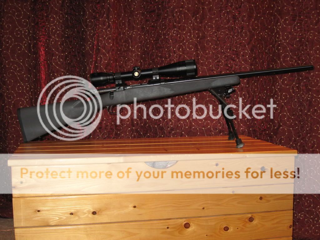

My rifle is stock, with a Bushnell Legend 5X15X40 A/O and a Harris bi-pod. Here is a fresh picture of her:

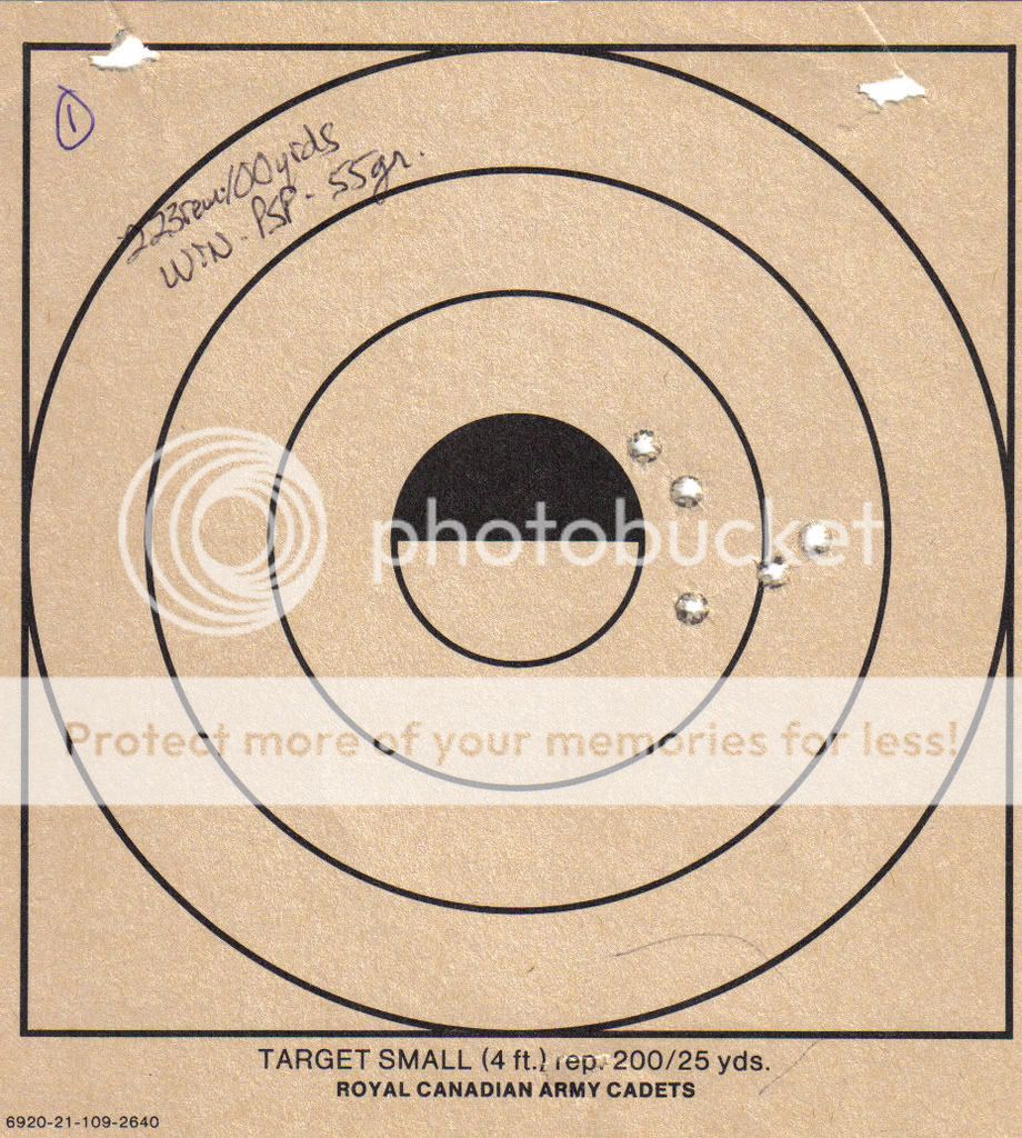

First up were the Win. PSP the average group size was 2" with the smaller one being 1"3/16. This also happens to be the best overall 5 shot group that I fired today.

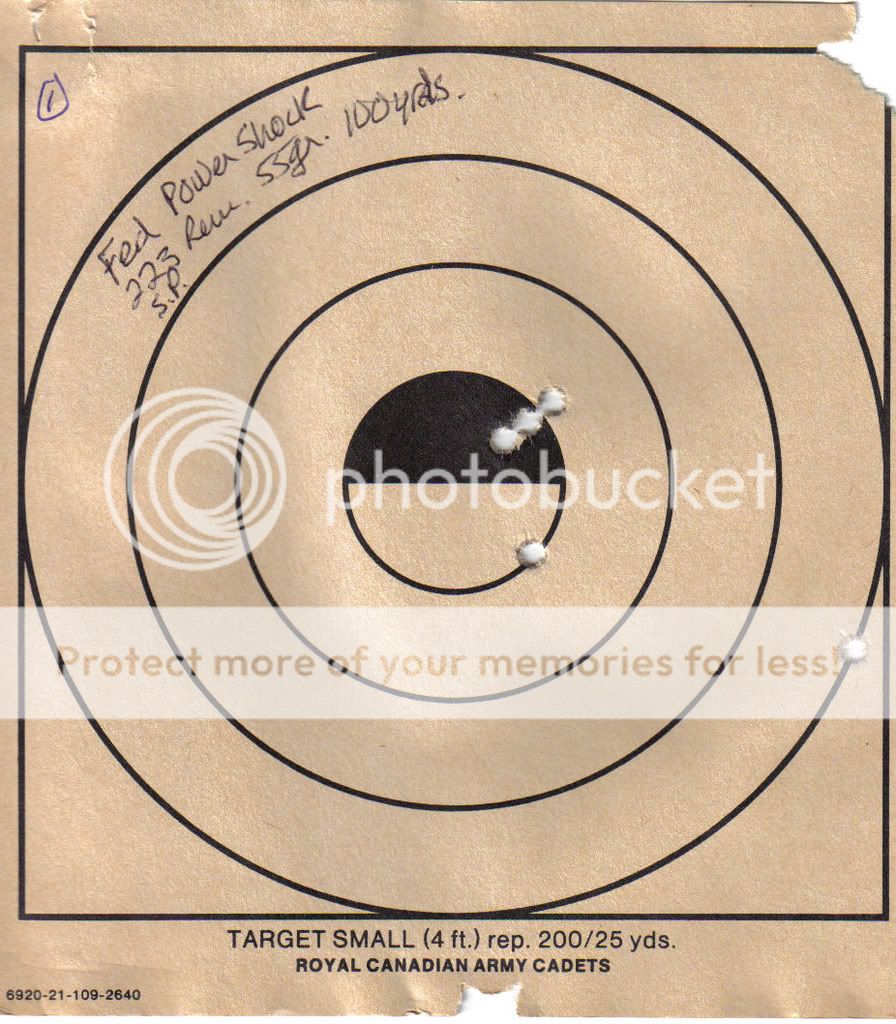

Secondly, I tested the Federal Power Shock at what I think might of been the most windy part of the day. I managed some decent groups, but there always seemed to be a flyer that would mess the deal up... The Power Shock delivered the worst overall average at 2"3/32.

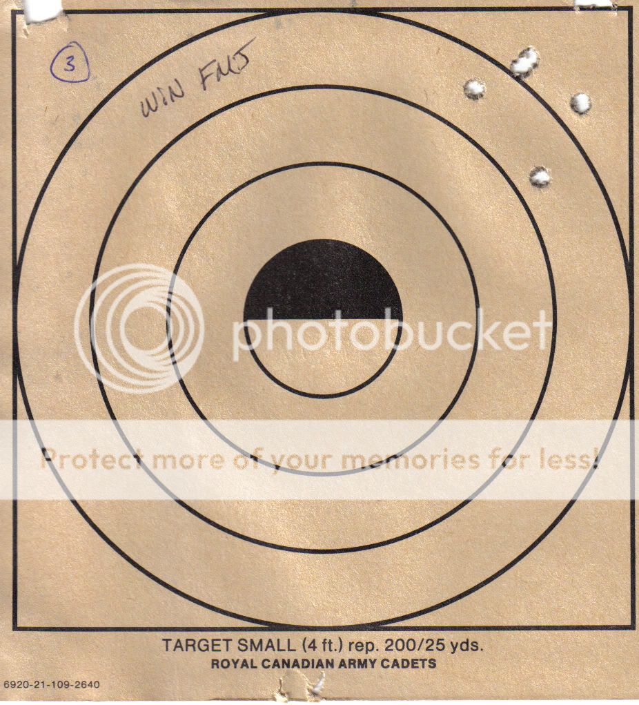

Finally, I decided to incorporate the FMJ's in the test for the hell of it and the little cheap buggers came out on top!:runaway: At an average of 1"18/32 the 5.27$ stuff kicked a$$.
Now, I don't pretend to be an expert shot, so take this info for what it's worth. If I would of only fired 3 shot groups instead of five, I guarantee that the average groups would have been 1 MOA. One thing is for sure, with the right hand-loads and a solid sled, this gun is sub-moa capable out of the box.

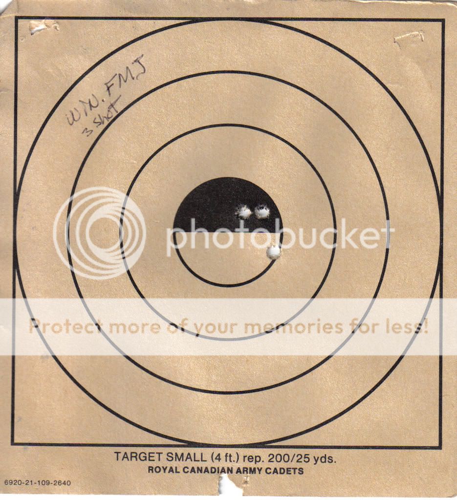

Here is an example of a 3 shot group (3/4") made with the Win. FMJ

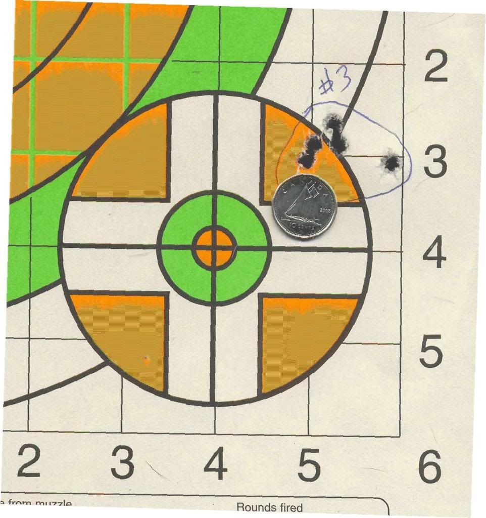

Not to hijack, but I took my Stevens 200 in 243 to the Range the other day to break in/ sight in. Like other folks have said, pretty good for a $300 rifle.
To be fair, I did bed the action, and replaced the factory trigger with a SSS trigger, and a couple of other inexpensive mods.
This is with factory loads: Federal PowerShok 100gr soft points.
I'm sure the flyer is the first round after cleaning, but with a Bushnell 3200 2 x 7, I couldn't make out the holes while firing the string. I think its time for Laser surgery though .... with the low power scope, no mater how I fiddled with the focus ring, the target wasn't as clear as I would have liked :rolleyes:
