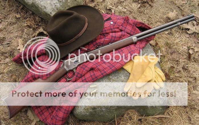

I don't plan to use this old classic Winchester this year for deer (I'm using a Winchester 30-30 carbine made in 1954, named 'Old Savage' for deer this year), but I just couldn't wait to see how this old Winchester would do. For those of you who haven't seen my old rifle, she's an honest rifle that's earned its keep over the past 95 years. Here she is ....
