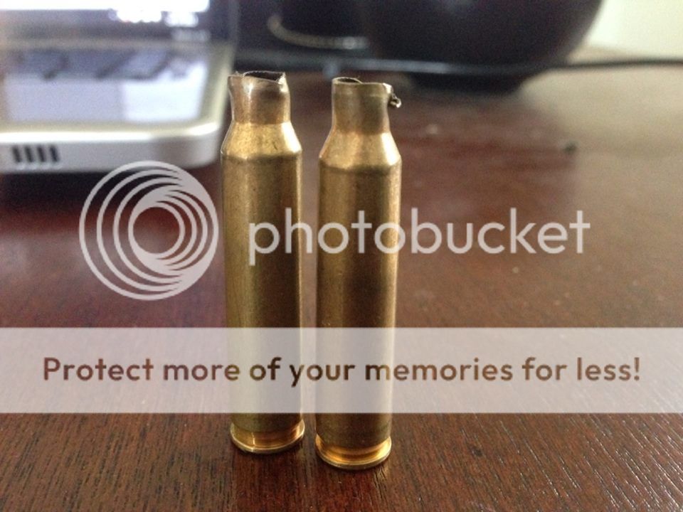

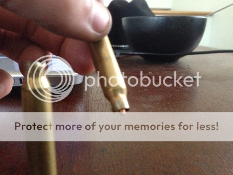

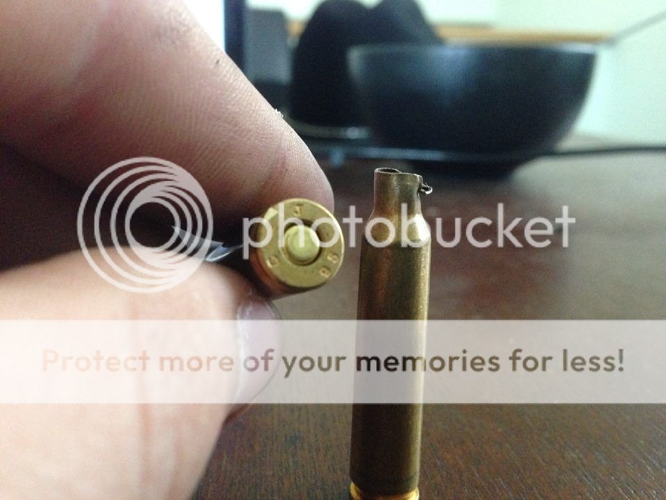

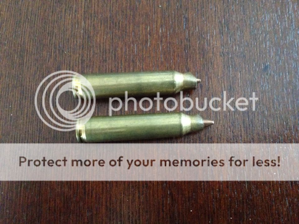

Went to the range today and fired finally some of the ammo I purchased from CANAM, this is the 95 stamped surplus non-corrosive 5.56 ammo. This ammo is much hotter then remmingtons factory load .223. The ammo did a great job, it's FMJ was able to penetrate two 2x4's screwed together without fragmenting. Even though my barrel has a 1 in 7 twist it didn't fragment even at 110 yards. The factory iron sights gave me 3 inch groupings at 25 yards and 8 inch groupings at 110 yards, No doubt this would easily hit a kill zone on a white tale if I were allowed to use 5.56 for hunting in this province. (Note don't use FMJ for hunting, it's illegal in most places in the first place and would be a very poor choice of ammo). On the down side, I fired 95 rounds and my gun was dirty. Very dirty. Also I should say I loaded 95 rounds I only fired 93. The ammo was so hot that 2 rounds pushed the action back and kept it back long enough that it tried loading two rounds. Also the CSA magazines (smoked plastic) need to be watched when loading, after you load a bullet you need to rest the primer against the back, for some reason it feel's like it could load a much longer round. Also when first cocking you need to let the action slam the first round into the chamber, if you let it out slowly it will catch, I believe people are refering to this as the gremlin, It didn't do this with remington factory loads and if I let the action slam it didn't do this with the norinco either. Here are the picture of the two rounds that tried to double load.
There is alot of powder behind these bullets, I found that out as it poured out the deformed case. This is my first review please give me feedback on my writing and inform me of any mistake I made.
First off, you should never ride the action when feeding the first round. The problem with the bullet being pushed into the case while feeding into the chamber is a known issue with Norinco 5.56 that I have read mentioned in a couple of threads. I'm not sure if it is a specific batch or all Norinco 5.56. The CSA 5.56 doesn't exactly have a great track record around CGN right now either. Could be an issue with the chamber size. It's just one of those CSA questions that have never been confirmed.

To the gremlin issue I said CSA but I meant the vz58/858 in general I haven't read up on it enough to know which guns were effected I just know that mine isn't. *knock on wood* I haven't had any issues minus the 2 pictured rounds above.
It is very apparent that Remington or Winchester factory rounds would be much better in my gun but for 25cents a round this fast flying norinco ammo is great. I wouldn't rely on it, but 93/95 is still 97.8%
I have a CSA 5.56. About 1200 rounds through it, mostly American Eagle Tactical and handloads of 25g. of Varget, all with 55g. bullets. The only damage on ejection is a slight crease just below the neck. I reload them. Everything I shoot gives 2"or better groups at 100m. I also tried some Norc ammo. I think it was '95. Fired about 200 rounds. I found the ejection pretty violent and and experience more than a few pushed in bullets which scared the hell out of me. Cases were creased also, just more than usual. I tried to reload the stuff but decided against it cause too many of the primer pockets were so loose they would hardly hold a primer. I decided to stop using the stuff before I blew up the gun. Norc ammo seems too hot for the gun.
