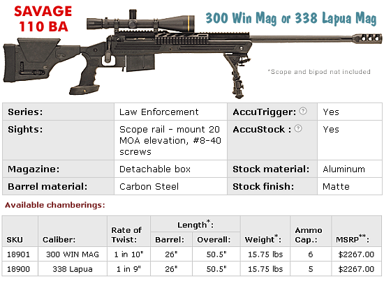

Savage 110 BA 338 LM have a 1:9 Good for 300gr
