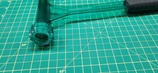

Hey, just wondering if anyone that has broken their rcbs hammer type bullet puller have the nut just laying around still intact? I broke mine and thought I would try here before picking up something new. cheerse5fbb9fb-e936-41c4-b8ab-25a892fedd35.jpg
Hey, just wondering if anyone that has broken their rcbs hammer type bullet puller have the nut just laying around still intact? I broke mine and thought I would try here before picking up something new. cheersView attachment 994067
haven't used one foor probably 30 yrs or so. Broke two of them and didn't bother buying another one. I may have been too hard on them, whacking them on a cement floor, but, whacking them on a 2x4 wasn't doing the job for me. What I didn't do back then, was make sure I'd broke the coldweld by breaking it, by seating them a bit deeper, enough to break that weld, maybe .010 or so. I don't really need one anymore, may have been useful with cast bullets, but, wasn't about to run out and grab one for just that. I can see their usefulness for that and stuff like round nose pistol bullets, or stuff seated too short for a collet puller to grasp, haven't had a need for it in a long time.

RCBS. Contact them on their website, (call or email) and they will replace it, no charge. I have had 2 RCBS and one Hornady replaced over the last 40 years. No hassle. Only issue is that it could take a couple of weeks to get it in the mail so I keep a backup on hand. That way your day isn't over when one breaks.
RCBS replaced the screw on top for mine a few years ago, but I recently broke the entire bottom off it last month.
Contact RCBS and ask for their warranty department.
They will replace it free of charge…:)
I too had one break as well. They replaced it under warranty.
No issues at all…:)
