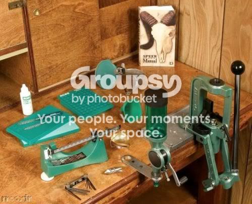

That's funny I just bought the same kit and I set everything up and went to zero the scale in but it wouldn't zero I tried for an hour ( leveling the scale, the table , went and bought a new level) then i got so frustrated I sat there looking at it with a coffee and smoke in my hand for another half an hour wondering wtf then I just happened to grab the brass pan sitting beside the scale and put it on the scale well yuricka what a dumb ass BUT ya you need the brass pan
Yeah this is one thing I don't understand, the manual makes no mention of the brass pan and it isnt even in the parts list.

if you want to level the scale as is...take a few pellets from a shot shell..
add them to to silver tray till it levels..
once you have it close take the pellets off the silver tray..
now see that screw on on the bottom (will be on top side if looking down on scale)of the tray?
undo that screw and add the pellets with the others you see in there..
simple as ABC....;)
I just added shot to the pan and zero'd it that way, hopefully my brass cup will be here soon I didn't wanna mess around with the scale too much.
