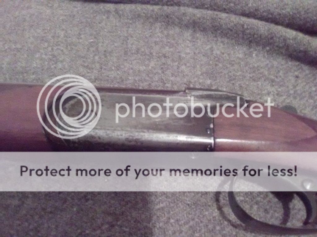

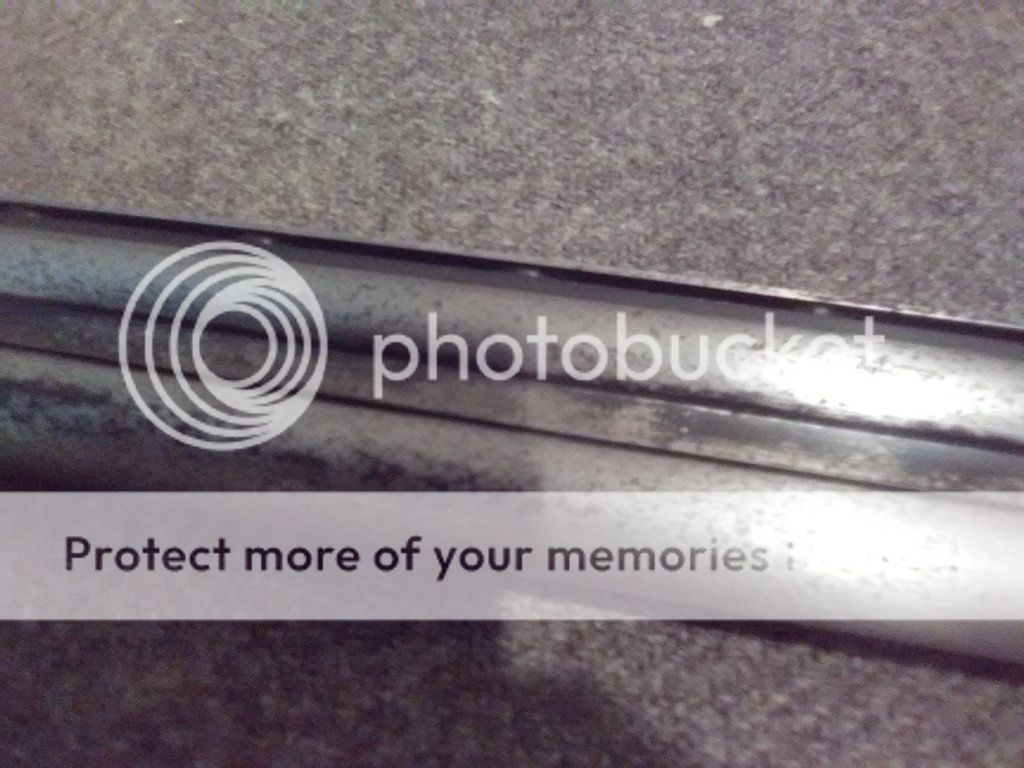

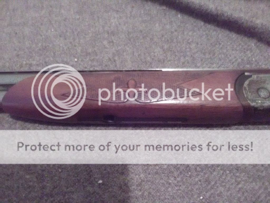

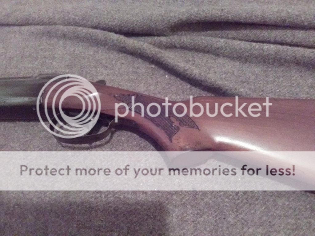

I have a valmet o/u 20 ga that needs some serious love and attention the original finish is 95% gone and there is rust pitting on the outside of the barrels there isn't much actual rust just the rust pattern etched in the metal. The actual mechanical parts seem to be OK and #### and click as they should and lock up seems solid so I think this could be made into a shooter. The wood is actually decent with almost all the original finish intact the stock has a couple cracks inside where the bolt holes for the tang are, and one big crack to the outside of the wrist on one side. The forearm is also a bit loose but not terrible. My questions are what is the best way to repair the cracks in the stock(hopefully without needing to totally refinish the stock) ? How do I go about tightening up the forearm? And what should I do with the metal bits? I have rust blued smaller projects before but an entire gun seems daunting mostly due to the extensive prep and polishing needed. Can an acceptable bluing job be done on a sandblasted surface? The other option would be something like armacoat or similar but it just doesn't feel right to "paint" an over under. Am I just being silly about it? I don't think the gun is worth enough to have it done professionally and I welcome the learning experience but would like some guidance from those in the know!

glass beads rather than sand leaves a nice smooth finish than you can smooth out with fine steel wool, than you could try your hand at cold blue.
If you want a matt finish that will work, high gloss blue , than you have a big job, real hard on a double gun.
The crack in the stock can be glued , is it loss?, has to be clean, no oil, you could cross pin it is nothing in the way, but that always looks like crap,
but that finish looks like crap from your pictures, but could be just way the color turned out.
A cooey 22 would be a better gun to practice on, but anything you do will improve it, trouble refinishing that stock is that checkering would be a pain in the butt to fix.
It is a pressed in , not cut checkering, if there was enough wood, I would get rid of it, or recut it.

My plan for bluing if i end up doing it would be rust bluing I have done it before on other projects with a mix of vinegar, peroxide, and salt heated and sprayed onto metal finished to around 320-600 grit with good results basicly flash rust , card off the loose rust and repeat till its an even brown then boil it in water to get a dark blue black oxide. I have no experience with cold bluing but I have been told its hard to do a good job on a whole firearm with it ... More of a touch up product. The other option would be to arma coat it .... Time will tell what happens to it. I know a guy who says he might want to buy it as is but if not I will likely try to refinish it just for the experience. It probably still won't be worth anything but could still be a decent bush gun
Yes , I have done rust blue, good if you take the time.
a lot of these shotgun frames are alloy, better check that.
If you want to do the work, I would recut the checkering, but that is a big job , if you have the cutters , a few hrs, plus if you fix the brk, need to be done, or sanded out.
