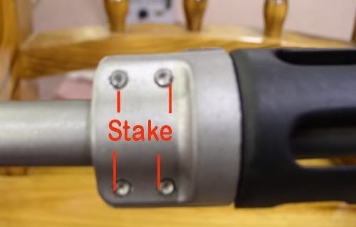

How To Remove Gas Block Screws
Start with a new 9/64" Allen wrench. They wear down pretty fast. To loosen screws first time turn screws one at a time loosen 1/4 turn then tighten to break the stakes (Chisel mark in screw threads). Do this 3 or 4 times each screw. Do not attempt to remove a screw (Leave them tight) till all the stakes are broken. If you strip a screw head, tap in a torx tip in screw head and loosen screw

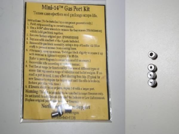

Replacing the Gas Port Bushing For Reduced Felt Recoil
This is the 3 pc set from Mike Knifong. It contains 3 bushings, complete instructions, and schematic. ASI also offers a set.
The 3 bushings on the bottom of pic are the replacement Gas Port Bushings. Note the Factory one on the top is much larger.
Adjust gas pressure by selecting a suitable size. Smallest for older mini's or very hot loads, Med. for mini's well broken in and standard velocity loads, largest for new mini's or low velocity loads. My mini has 1500 rounds thru it, so the largest works best for it. The largest is still way smaller than factory. This has resulted in a reduction of brass launching & damage, also reduces felt recoil.
1. Remove your gas block screws as described in page 1.
2. Remove lower gas block half, being careful not to loose the little port bushing.
3. Swap-out bushing to new size.
4. Reassemble as described in page 3.
Note: If your rifle has any of these symptons; failure to eject, failure to feed, or trigger does not reset, then replace bushing with next larger size. If you have a "Recoil buffer" it may compound the problem. Fix by triming, or increase gas bushing size.
