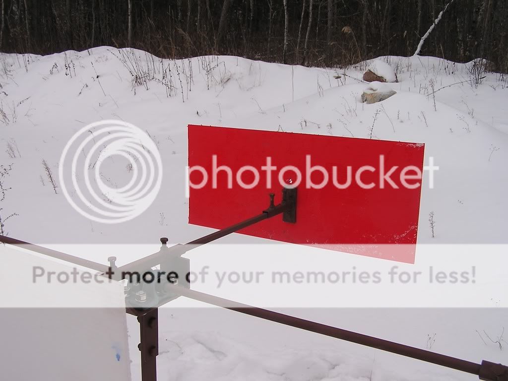

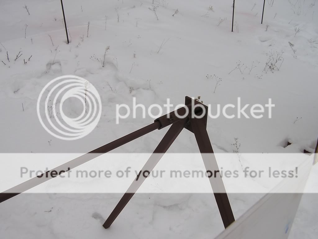

Tested target today and red back panel easily seen at 600 when hit with .308. I get a lot of questions on how I build some of my targets so here are detailed photos.
Ok, honesty is the best policy. This is my version of a target that is available on the internet, however, I need to make various sizes to practice for FTR so cost would be prohibitive and I weld for a hobby. The bearings are from Princess auto, the polycarbonate sheeting is from Rona. Plate is AR400 steel. I should have squared up the panels for the photo shoot but rifle shooting was the priority.

Target size
Not a bad guess. Yes it is 8". It was one of the AR plates I had laying around the shop. Stuff for FTR will be different size. Just had to try it before I got too carried away.

That is an awesome design. Works like a charm.
Just need to make a second smaller plate to hang in front of that one in the middle to know if you hit center or off to the sides. Rig up 2 sets of swinging thingers. If thats possible.

If I may make a suggestion, put this in front of that cardboard target that is to the right in the top pic.
If you miss with that much snow, you will not likely see where the bullet hit and adjusting for misses is the info I want.
Good luck with your smaller targets.

The large gong is our sighter. With fresh paint you can see hit location with a spotting scope at 385.
