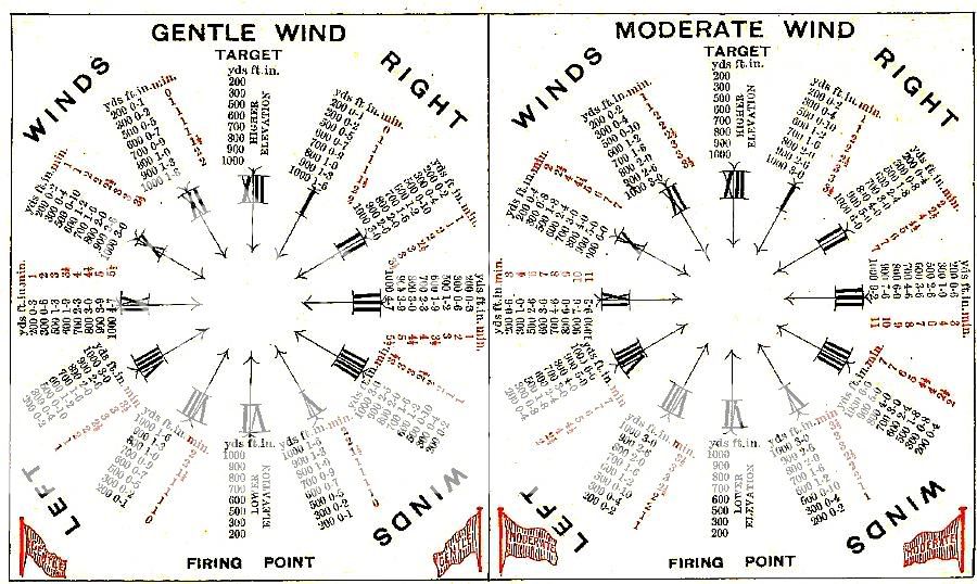

For something considerably more "Old Timey", here are the wind charts from my 1913
"Parker's Rifle Shot's Register" for the "service rifle" types of competition with the .303 Magazine
Lee-Enfield (i.e. "Long Lee") then held under U.K. National Rifle Association rules, at ranges out
to 1000 yards. (This data would actually date to about the mid-1890's, when cordite
replaced the original compressed black powder load of the .303 cartridge, and the
Metford-rifled barrel of the Lee-Metford rifle was changed to the Enfield-rifled barrel ...)
Wind strengths of "Light", "Moderate", "Fresh", "Strong", "Very Strong" and "Gale"
(and approximate appearance of wind flags for each), giving bullet movement in feet and
inches (and sight adjustments in minutes of angle) at standard ranges from 200 yards
up to 1000 yards. These charts apparently make no specific provision for elevation changes,
depending on wind angle, except the general indication that "Higher Elevation"
is required with a face-on wind and "Lower Elevation" for a following wind.
Note, for example, that a "Gale" force full crosswind would drift the bullet 27 feet
6 inches from point of aim at 1000 yards ...
