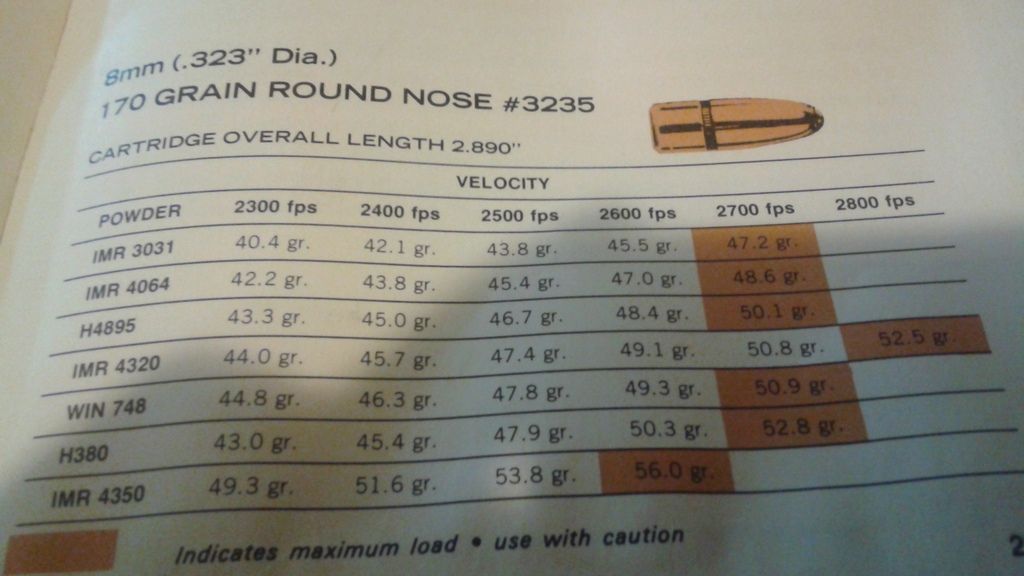

Here are some warm loads done up by realguns.com
That's a few more stout loads for sure! Found some in an older Lyman manual as well that also use IMR4064 supposedly pushing 170gr just over 2900fps.
Can't wait to try some of these. Hopefully find an accurate stout load with all the new info. I'll be sure to post updates but it will be awhile as we are still in a deep freeze here.
