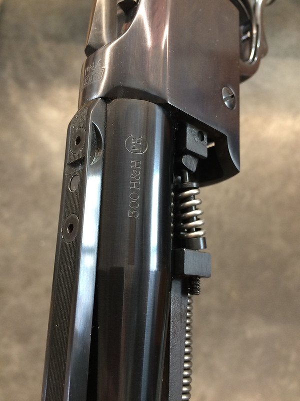

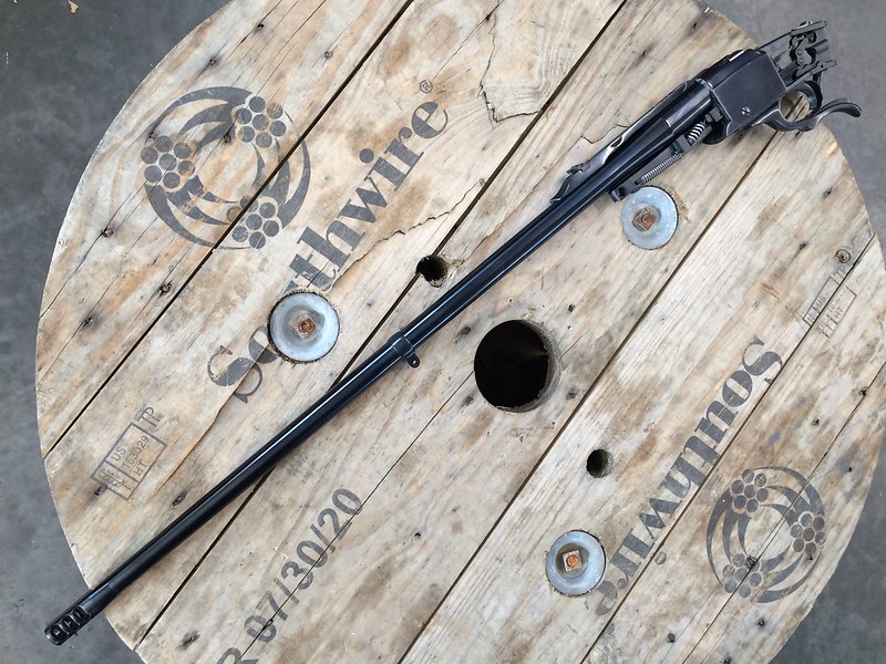

I am also happy to work on No1s, Here is a 300H&H I recently put together.
Wow....
I mean, WOW....
I clicked through to the Flickr Album, and looked around....
Jayzus, I wish i had half your talent and drive! :)
Nicely done! Both the work shown, and the very well framed pictures of. You should do well, in any field you apply yourself to!
