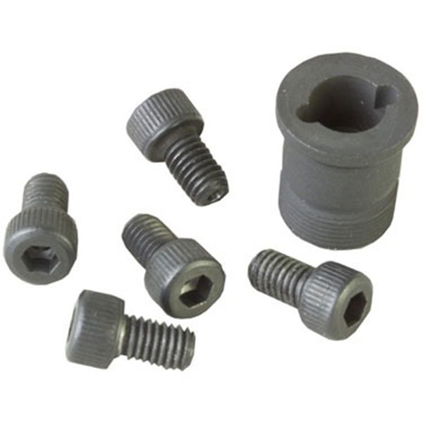

Anybody got any idea what the best commercial ammo for a Garand is. Plan on eventually reloading my own ammo for it, but for know thats not an option.
a Hollow gas plug that is tapped for various sized bleed off apertures, you keep firing / changing the jets until your Garand operates reliably but does not beat up the brass too much.
here is a pic :
Brownells used to export these to Canada, but they don't anymore, but I heard from other cgn members that Elwood Epps has them in stock. :wave:
information link:
http://www.brownells.com/.aspx/pid=1538/Product/M1_GARAND_ADJUSTABLE_GAS_SYSTEM
