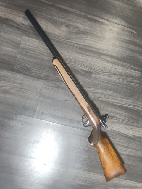

Finally got this from the EE, and it turns out to be a Mo 3. The original intent was to just make a stock/chassis from scratch (something I've wanted since day 1 of having a PAL) and then sell either this, or my CZ 455.
From what I read, these are the rarest of BRNO's and quite the accurate rifle. I have a dormant 4-16x scope that would work great on this.
The Bad:
Whoever had it before shortened the barrel to 20", lobbed off the end of the stock (badly!), removed the checkering and beavertail, disposed of the magwell/trigger guard, and barrel tuner and opted to make it a single shot via a pressed alu block.
One of the magwell threads are stripped, but that can be fixed with either weld, plug, or larger screw.
The Good
The trigger is very crisp and light, and the action is just as smooth as my CZ. There isn't any rust and the bluing still looks deep. The checkering left on the stock is great and old-worldly.
I will use my CZ as a reference and try to base it around using the same mags if I go through the trouble of making a magwell. My first rifle was a single shot, and I'm not bothered by reloading.
Luckily I'm a machinist and woodworker so this is all very doable on my end!
If anyone here has one of these, let alone spare parts (Magwell is main priority) I would be very happy to talk to you!

I think carving a Schnabel forend is going to be the best/only way fix for where they lopped it off. Taper it after the magwell, and make a new bottom metal and trigger guard.

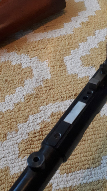

Not sure about optics here. It uses the uncommon 15mm dovetail size and I want to put a 30mm scope (4-16x) on it.
My options are:
Tap receiver to add a piccy rail (much work, too tall, permanent)
Mill dovetail down to 11mm (seemingly best idea) and spot reblue, use any rings you want!
Mill 3/8 dovetails and add iron sights (a lot of steps involved and costs more than rings)
Find the OEM replacement irons (LOL)
As for the mag, I will have to design or find a magwell (any ideas?) or keep it single shot with the alu-block pressed in. I think that step depends a lot on how well this shoots, but I don't know that until I get an optic mounted....

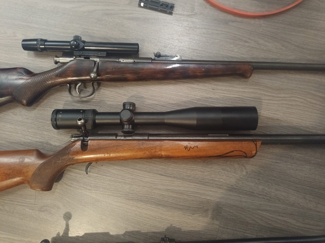

Maybe measure that rail again. I have a BRNO No. 1 - the rails are 16 mm. For European sizes, you measure the widest tips at the top of the dovetail. Bases made for CZ527 are for 16 mm dovetails. I removed the recoil stud in the one base - they now fit and grab perfectly onto the rails on the BRNO #1. I happened to use Warne brand rings made for the CZ 527 rifle on my BRNO #1 - likely other maker's rings might work as well??
FYI - I posted elsewhere on CGN - my first attempt to install a 2-7x33 Leupold rimfire scope - I used the Medium height rings - lots of clearance to barrel for objective end, but the bolt handle would hit the eye piece - I could either bend the bolt handle and re-inlet the stock, or use higher rings. I used the High rings and they work fine now. The OD of the eye piece is about 1.565". The rings that I used are Warne Maxima 1" 2B1LM - the 1B1LM were too low.

If you do get into milling those rails, might want to research the various sizes that standard rings are made for. European size was 11mm across top flats, and used a 60 degree cutter. North American was 3/8" (.375) at the bottom, inside narrowest part of dovetail - and used a 45 degree cutter. For a few years, CZ 452 were made with either railing - is both sizes out there - one version takes European 11 mm ring clamps and one takes North American 3/8" ring clamps.

Your rifle has 16 mm grooves. Very easy to find mounts, though they aren't necessarily cheap. PM me if you want a set for the price of postage. Can't recall, but you might have to file/grind out a recoil lug on one of them. Five minute job.

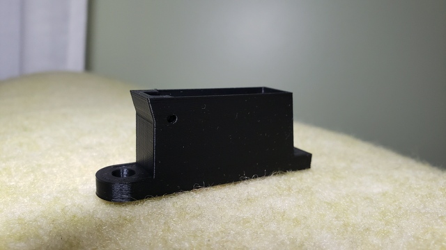

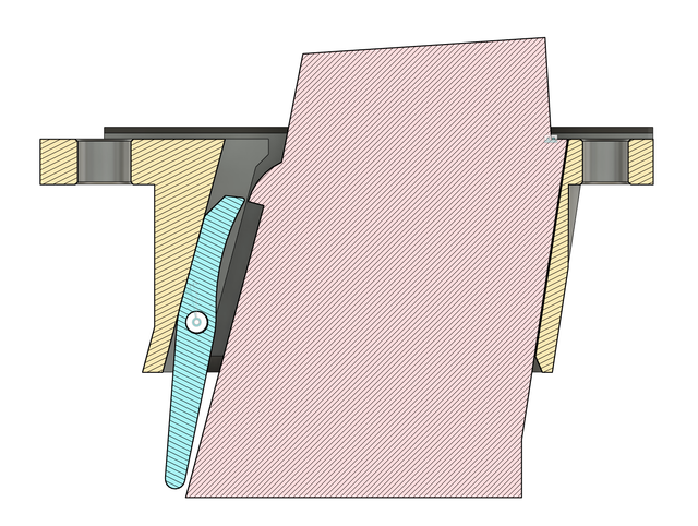

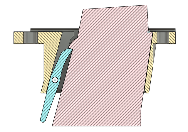

I took the mag from my CZ and held it with my thumb. It flawlessly cycled 5 rds, which means I have to make a magwell for this....So here goes! Luckily, the ejector is steel and part of the receiver which makes it easier to fab. Current CZ's have it as part of the magwell, and from plastic.
The mag release knob is also a tad longer than factory, but should make it easier to activate! The spring can probably come from a pen without any issues. Going to be 3d printed prototype this weekend if all goes well.
I have rings en route from a generous CGN member so I can attach a scope. I will ignore iron sights for now and focus on carving the stock. I also fashioned a trigger guard tonight that I had leftover from a scrapped Cooey

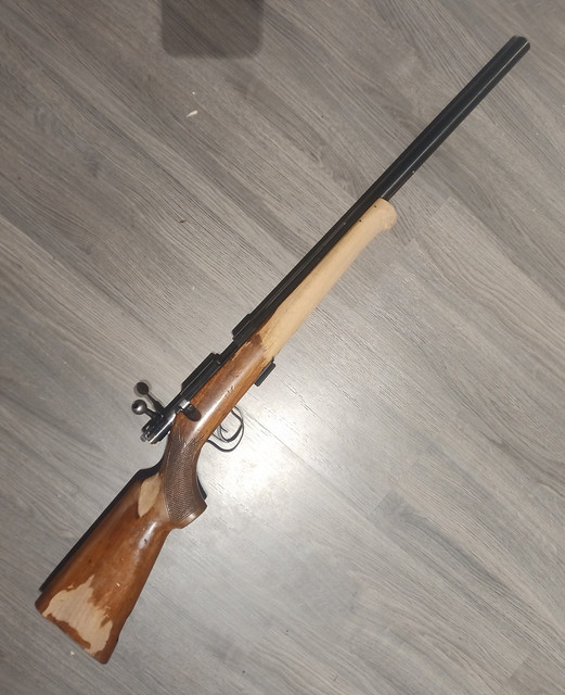

Carved the stock in 20 minutes - reminds me of the days I used to build guitars! Felt nice to pull the drawknife out of storage.
I might move the Schnabel closer to the end, it looks a lil' chunky in the photo now that I've stepped back. I will probably add an adjustable LOP on this with some stainless steel rod, not sure if I want to also do it on the cheek or not. Main priority was to make sure the mag still sat very flush to the stock. Debating buying 10rd mags or not, I have a lead on 2 steel ones for 100$ shipped. Still hemming and hawing if I'm selling off my CZ and making this my main target/precision rifle.
My buddy printed the magwell out today. Looks pretty good! I appreciate the source on Wolverine (is it always called a magazine housing? I've only ever heard to it as a magwell) but they want 18$ in shipping. If this printed one doesn't work (it should, I can do another at 100% infill if the dimensions are right and theres little stress on it) I will have to go there. analemma also mailed me the 16mm rings today!
