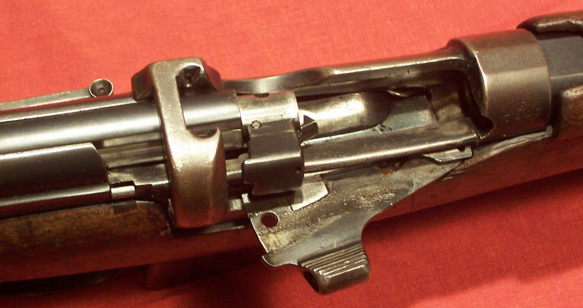

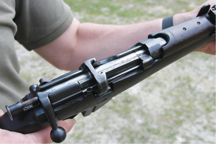

I was looking into the No.1 Mk3 rifles since I kinda want a proper matching example one of these days, and noticed most rifles have a Notch above the breech, on the receiver ring. I found some pics of rifles without it however.
Was it an early feature that was deleted or the opposite? I have seen pictures of early rifle with the notch as well as later rifles, and same thing without the notch.
Here are Some Google Pics.
With the Notch
Without it
