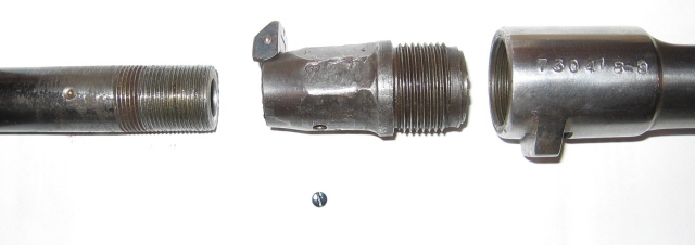

I have all the parts ("Cooey Eatons Carcano", and Lee Enfield barrel), I'm just waiting for a local "amateur machinist" to have some free time and I'll git er done.
Compare the 7.62x39 to the 303 Brit round. Cut 0.600" off of the chamber end, re- thread and you're good to go. The neck will be a bit short (0.100") and the shoulder will be slightly "improved", but it will work just fine.
An interesting way to attach the barrel is like what is done for modern Savage firearms. Leave a barrel "stub" from the carcano barrel, and thread it and the Lee Enfield barrel so that you can screw it in until headspace is correct, and affix it correctly indexed with a set screw.
Yes, with careful fitting, a 7.62x39 reamer is not required. I've not done it that way, but have done the job setting the .303 barrel back a bit more, and finish reaming the chamber. I've done conversions on both the Lee Enfield and Cooey-Carcano.
