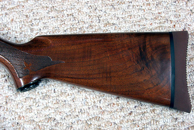

I had a Pachymeyer Decelerator D550 recently installed on my 870TB trap gun. Looks great, feels great.
