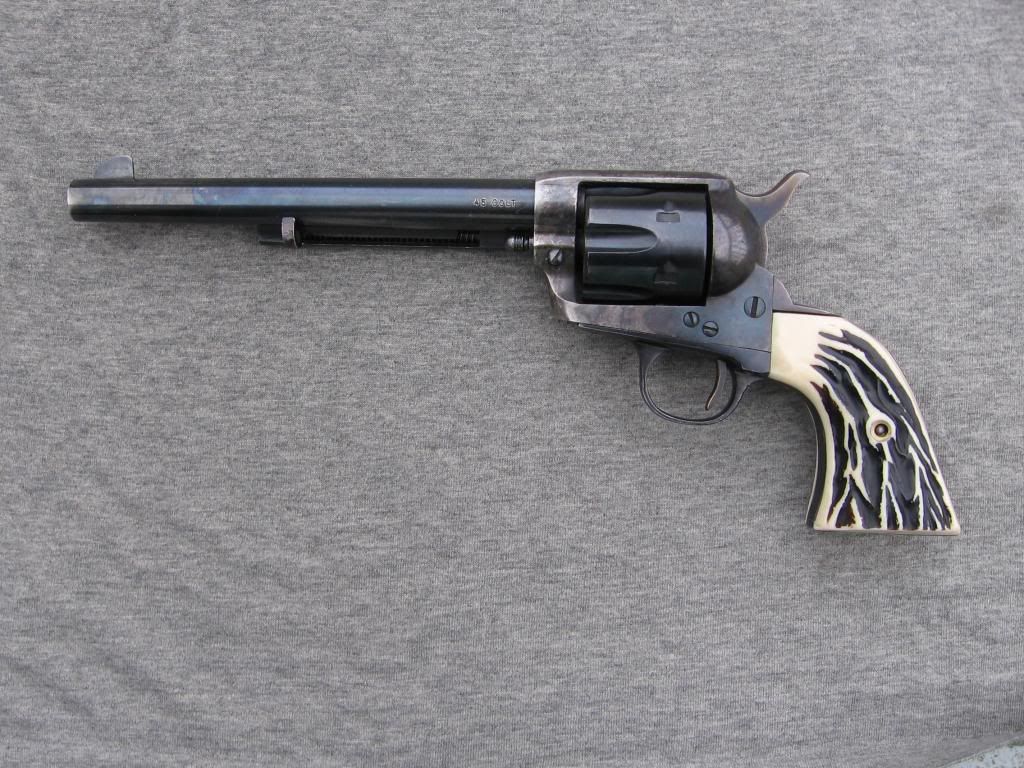

I recently bought a Great Western Arms Single Action .45 Colt which was made in 1954, when I got it my first impression was that it had been shot very little, turns out it has been shot a lot. The problem is with the recoil shield shown in the picture: when fired is seems that the primer blows back and takes on the concave shape of the worn shield and when I try to index the cylinder for the next shot the now protruding primer drags on the frame. This is not a minor annoyance it is a full blown jam and makes shooting the gun very difficult.
I am wondering if original Colt SAA,s had the same set up for the recoil shield, I have a Uberti Cattleman and it doesn't have one.
The gun is worth the effort as it is very solid and a straight shooter....best group ever.
