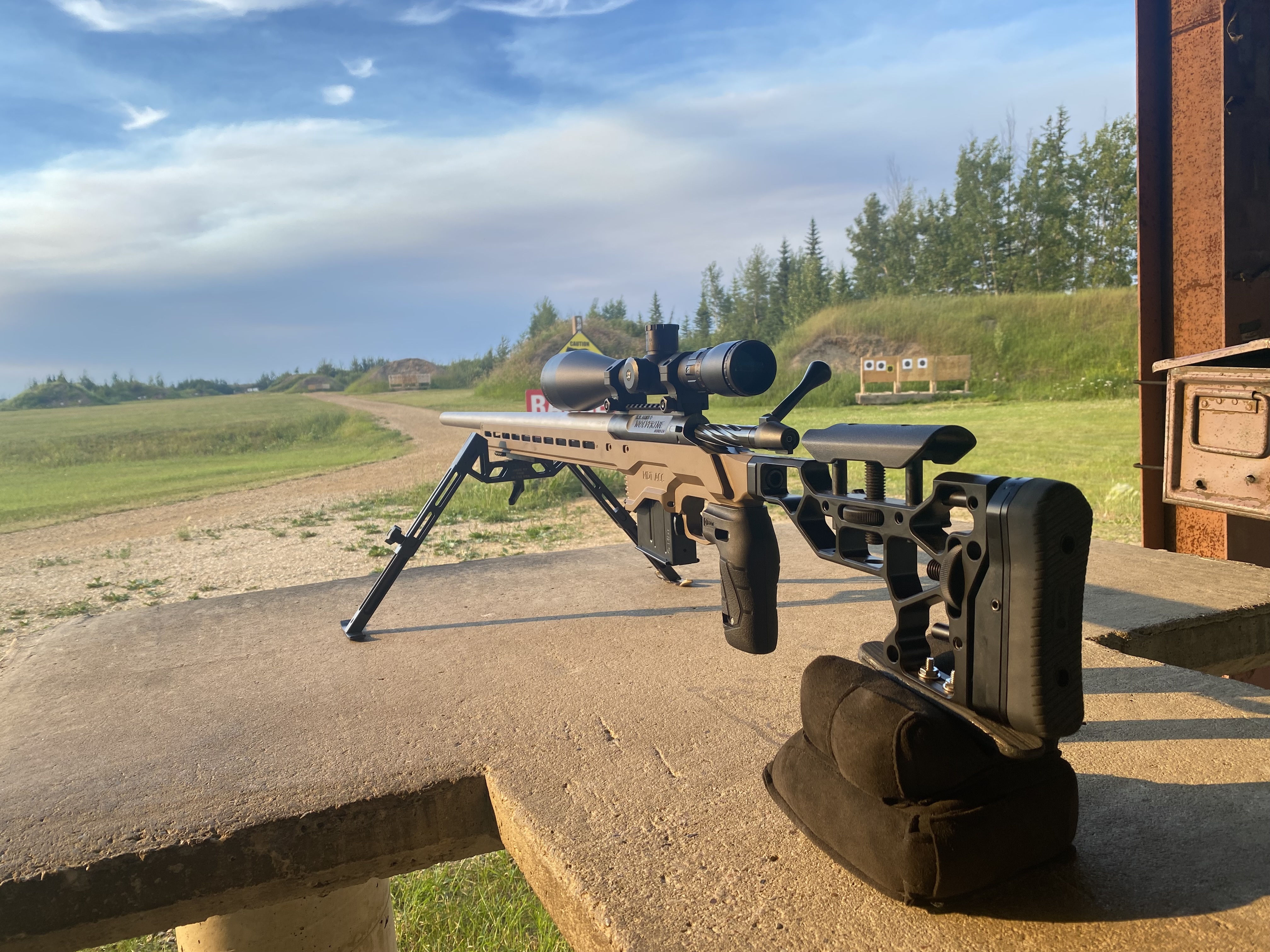

I like to dual purpose my equipment between pb and airguns, the 10-50x60 scope works well also the tripod as a front rest is almost acceptable for 308 with some tweaking. Here I want to try some specialty bipods if makes much different.
To fully answer your question, most of the time I train and practice 100 meters rings BR with my .22 and .25 PCP air rifles.

With this setup (as pictured) I can consistently get a five shot group size in average of 45mm=1.77" @ 300 meters without any extra effort.
(last measured at 23C, 75% humid, 1021 mBar, some light swirling/gusting wind in the valley).
Also, the gun is way too lightweight at 6.8 Kg in this setup.
Most likely I will get the MPOD, if that improves the group size...that asks for a trouble.
I am not entirely comfortable with the synthetic stock, yes I modified it somewhat but there are things I cannot used to ergoniomics entirely.
I am predicting that a heavy chassis is a next step if I want to dedicate to longer distances, but for now that will wait the summer is over.
