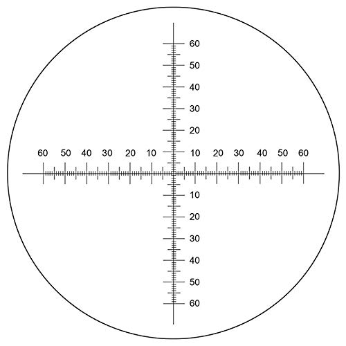

The cheapest route would be to
A) try a 1.25" microscope eyepiece with reticle in your current spotting scope
B) have a reticle added to your current eyepiece
https://meijitechno.com/how-to-install-eyepiece-micrometer-into-ma535/
I’m trying some Google searches and this seems a bit complicated for me. How would I know that the eye price would be displaying true Mils? Is that all just in the eye piece or does it need to precisely fit into the spotting scope body?
