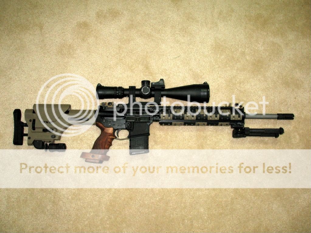

Spikes makes an 18 inch Lothar Walther stainless match barrel, 1:8 twist, 18 inches. Its free floated in a Daniel Defense lite rail.
I shoot Federal Gold Medal Match in Sierra 77s.
b:
WoW!
That looks like it could pick a flies butt off at 400 meter's.
Nice rig ;)
