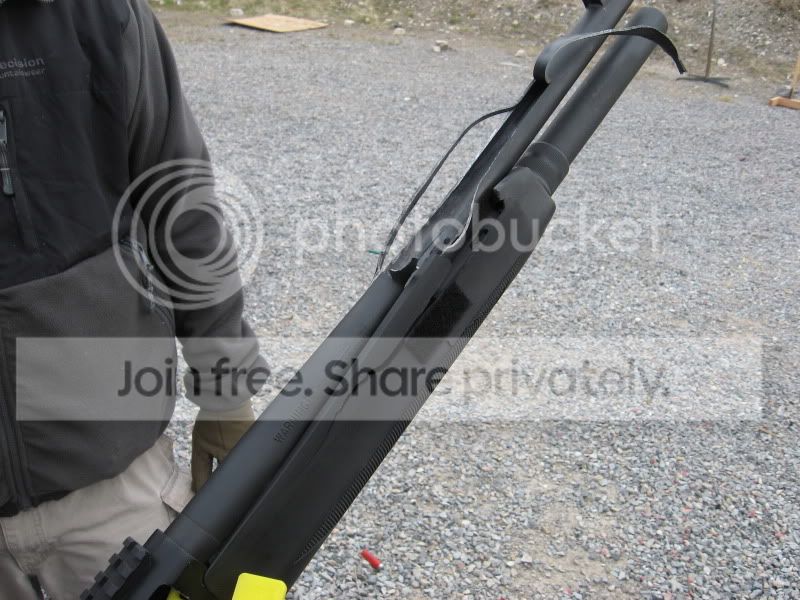

Not a pressure failure this time but a pic that was sent to me last week of another one of those SAFE waxed slugs that some do.
