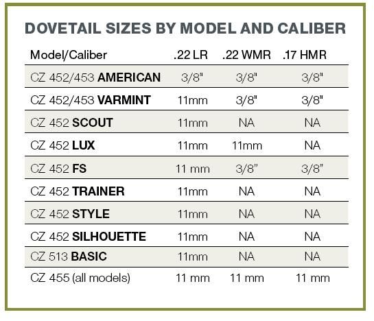

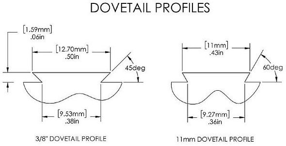

When buying a dovetail-to-weaver/picatinny adapter for a CZ 452, users should be aware that dovetails vary by model and caliber. Some have a 3/8" dovetail, others an 11mm.
I will edit this post to add the comparison of the two dovetail sizes.

I got these from the East India Company of retailers, and they work perfectly on my 452 American, which has 3/8 dovetail. Won't work on 11mm. Let me use a variety of parts-box Weaver scope rings.

Mine could have been a different brand. I couldn't tighten the Weaver clamp over top of them enough to keep the scope from moving. Work on the 3/8" dovetail find tho'.
