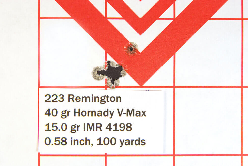

https://www.americanoutdoor.guide/survival-skills/reducing-centerfire-loads-small-game/#:~:text=As%20for%20my%20needs%2C%20reduced%20loads%20for%20the.223,Alliant%20Unique%20have%20been%20tested%20in%20those%20loads.
Most reduced loads would be employed to take small game and pests. It is pointless to produce such loads for the .30-caliber cartridges using strongly constructed 150- to 180-grain bullets for large game, because they will not expand.
As for my needs, reduced loads for the .223 Remington involve two velocity ranges. First are the loads that run 1,200 to 1,800 feet per second (similar to .22 LR and .22 WMR loads), and both Hodgdon Titegroup and Alliant Unique have been tested in those loads. For loads in the 2,000 to 2,500 feet-per-second range (similar to 22 Hornet loads), powders tested include Alliant 2400, IMR 4759 and 4198, and Accurate 5744.
