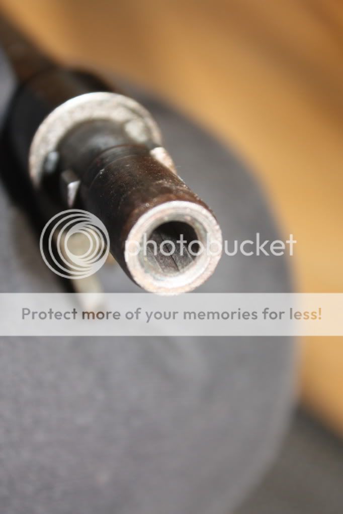

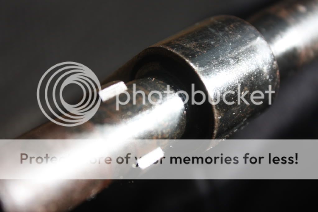

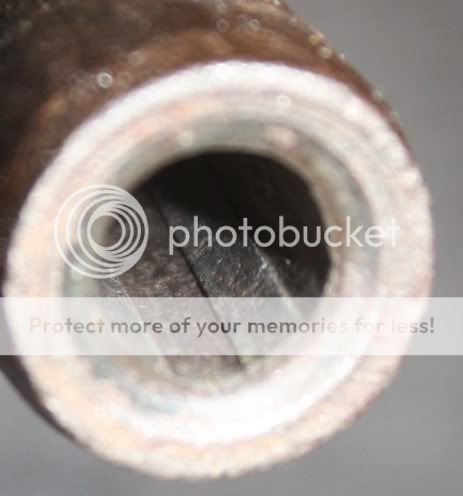

A good idea to shoot it before investing too much $$ in it. The muzzle crown looks OK, but the bore shows pitting. A lightly pitted bore can still shoot well if it is not overly worn, but it will foul quickly because it strips metal from the bullet jacket.
I'd give it a good cleaning with a brush/solvent as well as JB paste before shooting it. If the barrel proves out OK and the receiver is sound, one solution for a metal refinish is to have it blasted and parkerized.

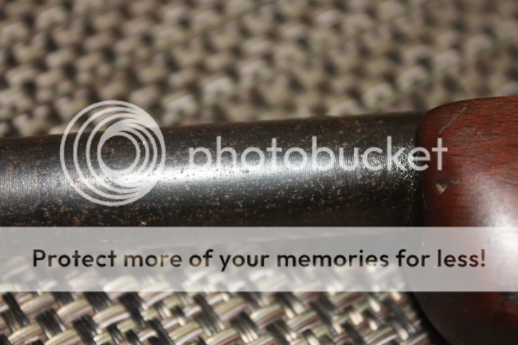

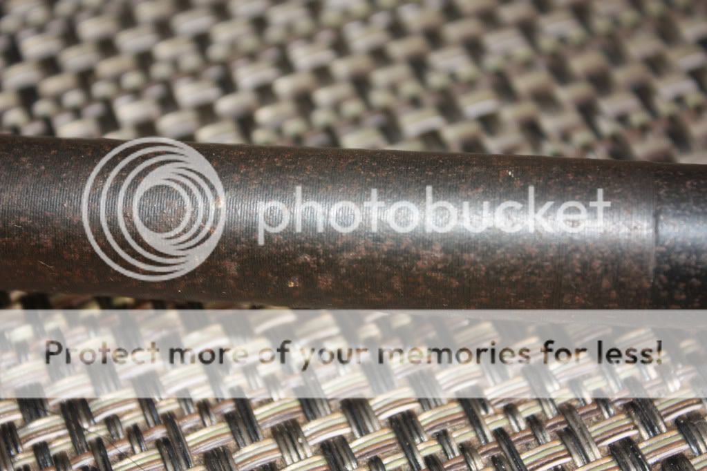

You may well find that with some wire brushing and steel wool you can bring it back close enough to be fine. I've had to do the steel wool and oil trick to a couple of guns and the results were very acceptable. Especially for an older workhorse gun.

Next cleaning like you stated use easy off oven cleaner it will save you work any rust left over take some #0000 steel wool and give it a good rub down.You can use oven cleaner on the the inside of the barrel it will clean it right out leave in and/on rifle for a least 10 min. or more then rince with very hot water from tap or boil on stove followed by cleaning patchs and oil keep running the patchs through until they come out close to clean/white the pitting you are seeing maybe fouling if it is the oven cleaner will remove it all the best of the time it will also remove all paint from the FTR it had years ago if any at the FAZ factory they used to park.them followed by stoving/paint the park what is left will be unharmed you could re stove/paint it or like you said repark.it if it had any to begin with [longbranch rifle or savage]

I bought the JB bore paste and ran it through the glun, cleaned the bore up quite nicely in my opinion! those pits in the last picture are barely noticeable, if this gun shoots well (ill determine that next weekend) then im going to shell some cash on a restoration!

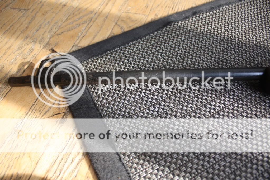

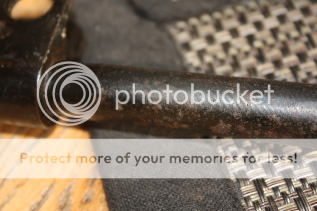

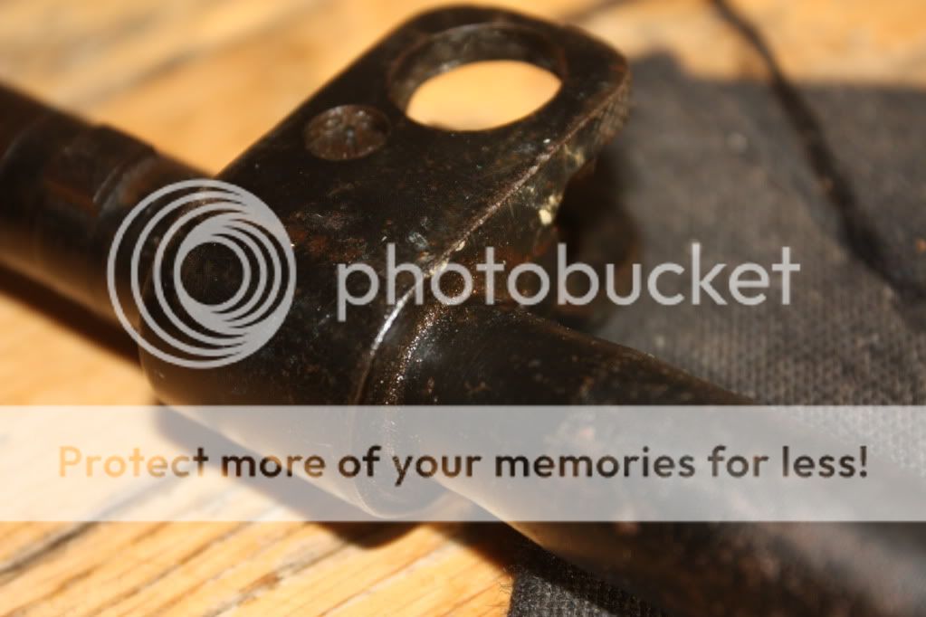

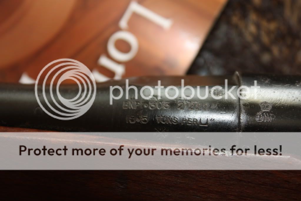

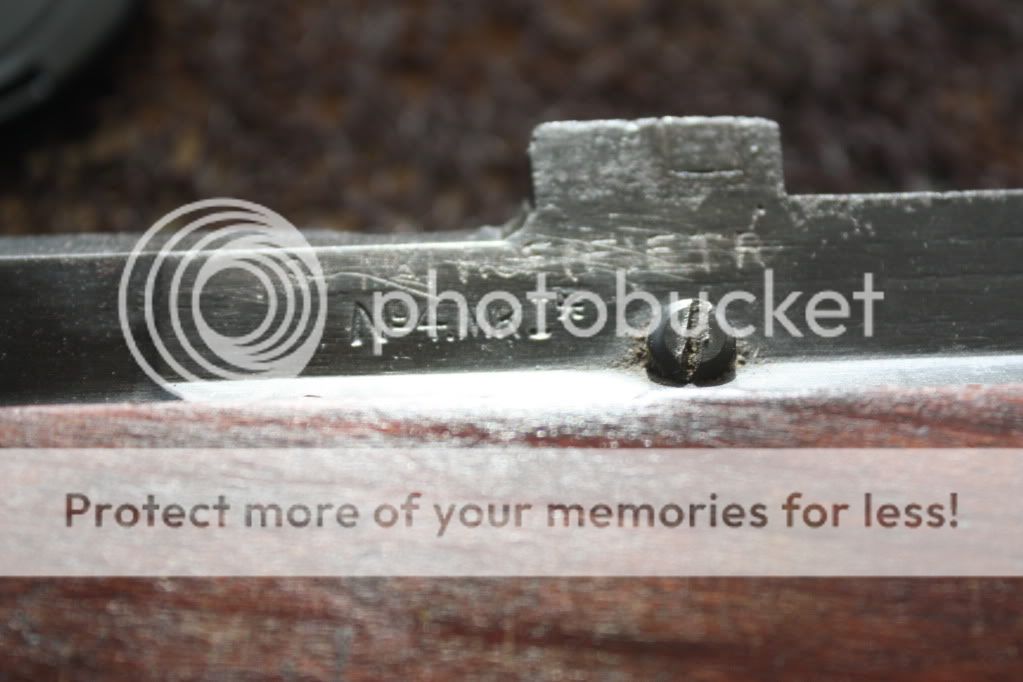

It is a No4 Mk I * so it should not be parked if you want the proper restoration. Looks like the bluing is intact for the most part. Those little bits of rust specks will wipe away with some steel or bronze wool. In my opinion, you do not need to bead blast and re-finish the metal.
Looks like a good candidate at any rate, keep us posted of your progress.
