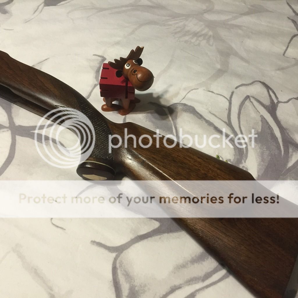

Thank you, Kurgan. I could have filled grain or applied another ten coats with steel-wooling in between, but this is a hunter not a show piece.
