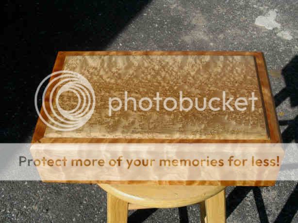

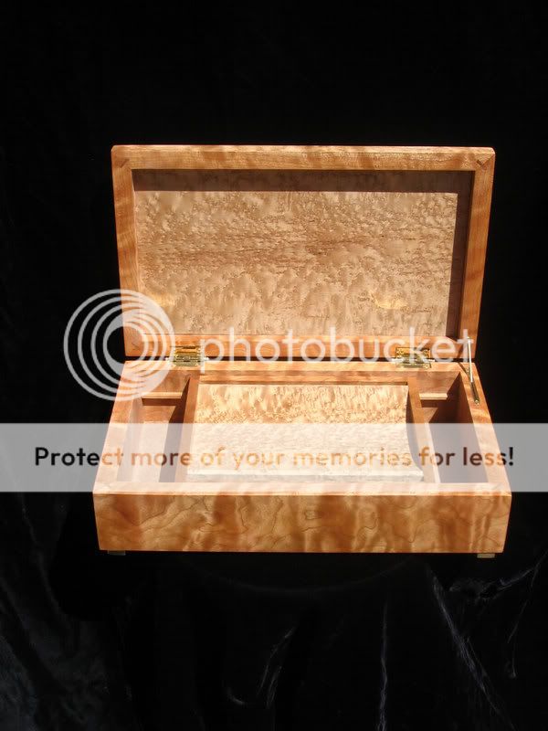

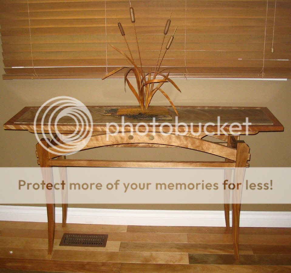

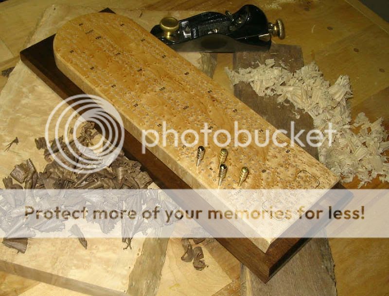

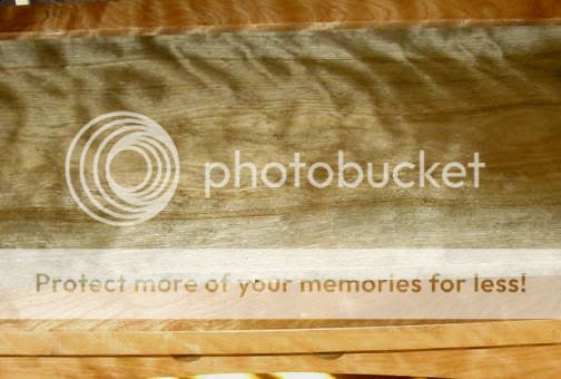

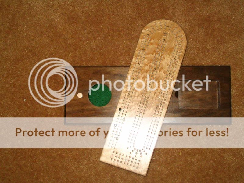

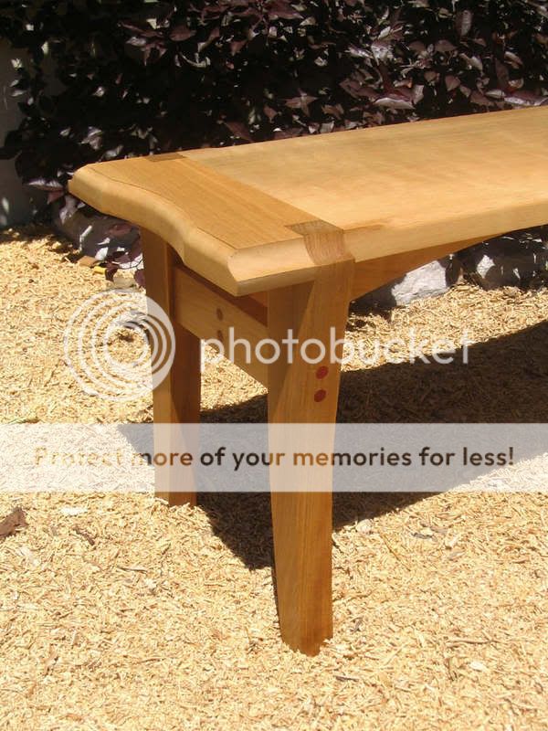

Ummm.....wrong. I use HVLP applied laquer, WB finishes, Oils, Shellacs, Varnishes, and friction waxes....but sometimes Poly is just what the doctor ordered. On truly "fine" furniture you will more often see rubbed-out poly or shellac than anything else. Most "commercial" furniture is laquer..not because it's better, but because it's cheap/quick to do.
All poly finishes.
Poly will actually do a much better job of protecting the wood than anything else you can apply without a spray unit. In fact, I prefer to topcoat tung-oil finishes with 3-4 coats of wipe-on poly (regular poly thinned 40% with mineral spirits) because Tung does not offer much water resistance, and virtually zero protection against wear. "Tru oil" is a good product, as it contains both oils and varnish, so you get the best of both worlds....but it still benefits from a poly topcoat,
