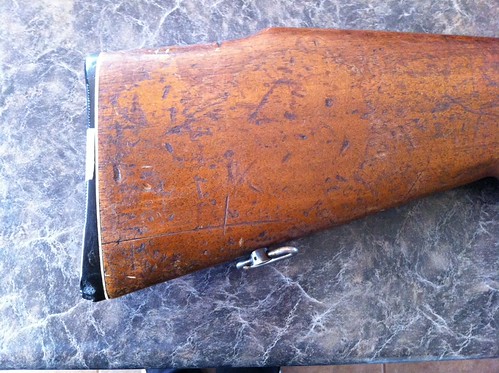

So the other day I picked up an old (mid to late 60's by the serial number) Sako L461 chambered in .222. I bought the rifle for coyote hunting. It had some dings and worn finish and stuff, so I thought I would freshen it up a little. Not a complete restore, because it's still going to be a working rifle, but just wanted to spruce it up a little.
Butt Stock - before

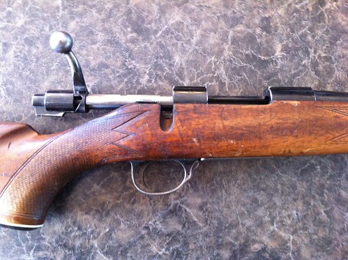

Stock under action - Before
Stock under action - After
I'm hoping to redo the bluing on the receiver and bottom metal, but I'm not sure the best way to go about it at home. Any suggestions?

Yes I agree with you. Since it's just going to be a hunting rifle for now, I'm just stripping it applying some urethane to keep the water off the wood. At some point I will re-barrel, re-blue and re-stock it, hopefully I'll have this little rifle for a while.
Sakos are nice guns I've had a couple over the years. Don't take this as a critique but a suggestion. If you wish to clean up the checkering some more get a fine brass brush and paint remover / acetone and go at it. Should you decide to re-do the checkering it helps to get all the grime out first and save your (sharp) tools, that stuff is usually full of fine grit. Mask it off before refinishing the stock or you'll be back where you started, checkering full of finish. A single coat at the end on the checkering will usually suffice. --- John303.
