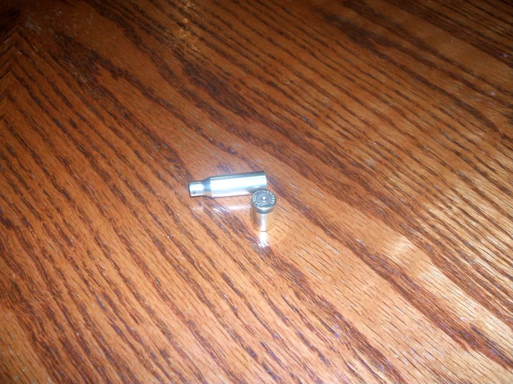

Was shooting my .223 rem this evening.
I was using brass that I picked up at the range and reloaded for the first time. The load was:
25.0 gr H4895
52 gr Sierra HPBT
PMC brass with military crimp removed
Case Size 1.750"
OAL 2.200"
This happened with one the rounds:
It was a good thing I was wearing safety glasses as I got a few powder burns on my face from it.
Any ideas what was wrong with this load?
I found some of the Korean PMC had less internal capacity than say Win or Federal and loads had to be reduced somewhat.That looks nasty good thing for the glasses......................try filling an empty case with H2O + a spent primer in it and weigh it on your scale,then one without H2O.......Harold
Have any more cases from the same batch? Section a couple and see if there are any signs of incipient separations.
The ammunition could have been fired in a rifle with excess headspace, setting things up for a failure when reloaded. The problem with range pickup brass is that you know nothing about it.
"...brass that I picked up at the range..." Like tiriaq says, you have no idea what has been done with that brass or how many times it has been loaded.
Certainly not caused by a starting load.

These cartridges don't break like this from too much pressure. The culpret is too much headspace. Just for a reminder, here is how headspace rupture happens. When a round is chambered, the shoulder will not be hitting the shoulder on the chamber, where it is supposed to rest. When the firing pin strikes, the cartridge is driven forward until it hits the chamber shoulder. Then it fires, the case expands and the chamber walls hold the front of the case forward, but the rear of the case is blown backwards to the bolt face.
This stretches the rearward section of the case and the weak spot is just above the thick web of the case.
Solution 1) Have a gunsmith tighen the barrel threads up to reduce head space. Expensive.
Solution 2) Have the brass fit the chamber and then only neck size.

The police likely fired these in a semi-auto, probably an M16 variant. These rifles have notoriously "loose" chamber and do fine firing all new rounds fed through them. Since the police do not reload, the brass get's left behind and you unfortunately have the results of reloding this brass in front of you.
Glad you did not get hurt, but be careful with range brass, especially in semi-auto calibers (that includes .308win which some shoot in M14's).

Yea incipient case head fracture. I have an enfield that I neck size for just because of this very reason. If you have headspace on the high side and full length size every time this is what can happen.
Use a flattened paperclip bent into an L shape and feel along the inside of the case wall for a section just above the case head. If the brass is starting to thin in this area you should be able to feel it with the paperclip as a groove or ring around the inside of the case.
