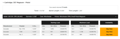

I have a box of 200gr Hornady FTX 0.358" diameter projectiles, designed for the 35 Remington as per Hornady's website. I note Hodgdon's website does list 200gr 0.358" lead bullets using AA#2 powder. I'm pondering using these jacketed bullets to put holes in paper at my local range. Definitely would not load near max, and could even use TrailBoss loads. I'm thinking squeezing jacketed bullets down 0.001" will increase the chamber pressure, but if I shoot with low-pressure rounds I should be good.

the load data above is from the Hodgdon website. Most 357 bullets are .358 and even .359 if they are cast lead or powder coated. I have reloaded for my M77/44 with great results. I did have to pay attention to the COL though as some cast bullets ended up too long for the mag when I set up to the the crimp groove in the bullet.
