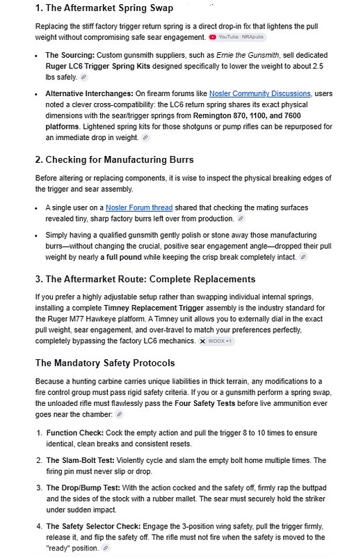

But do tell me more about these Heavy LC6 triggers... I didn't think they could be adjusted??
Mines a Whelen mkii Hawkeye , heavy but Crisp trigger....
Nice groups and different set ups on the same gun eh
The easiest way is the Timney replacement trigger. If you put the Timney trigger/sear and stock spring in one rifle, and put the stock trigger/sear and Timney spring in another rifle, you can generally end up with two very crisp, light triggers with one Timney kit.
