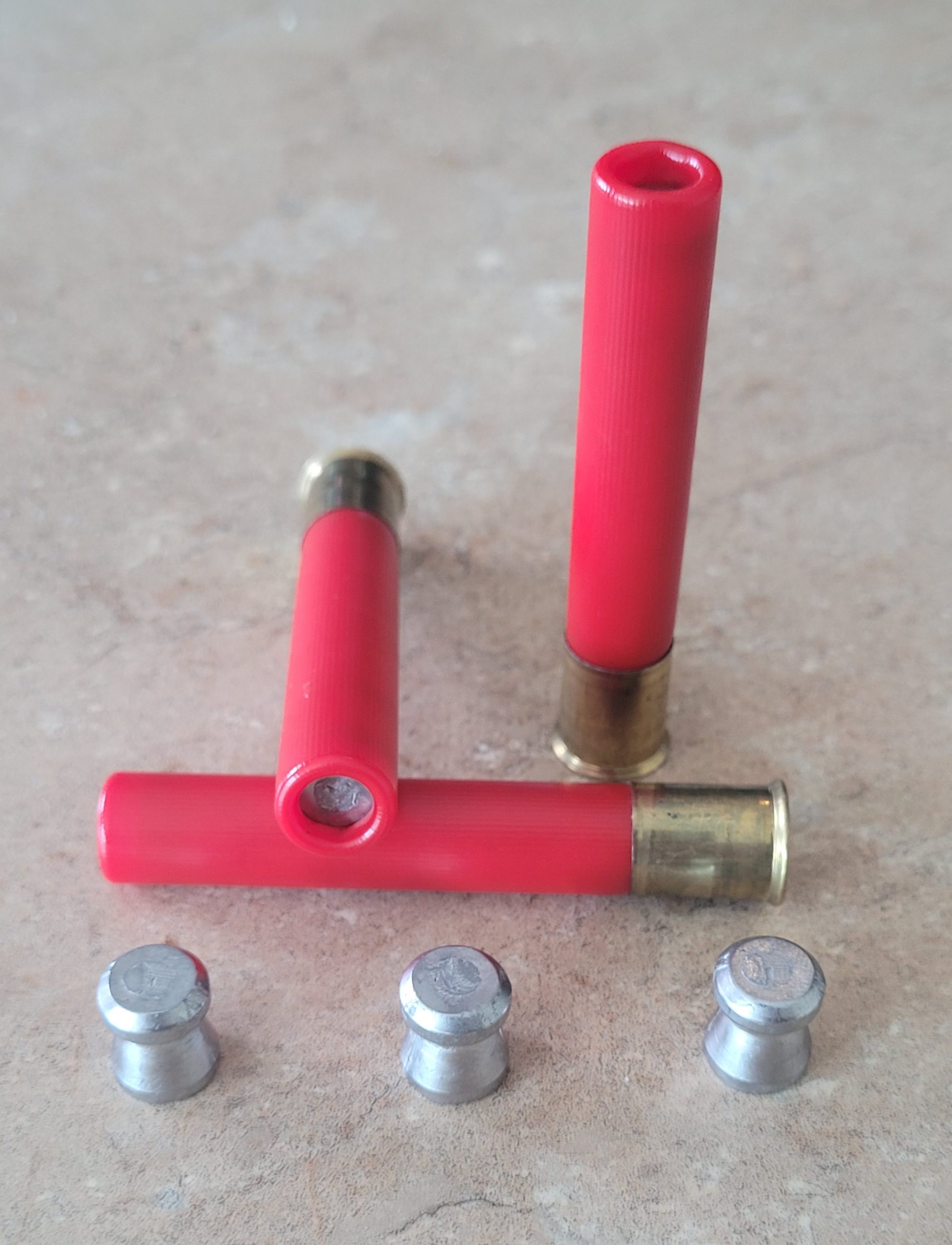

Reloading .410 Lyman (Diablo) slugs.

Anyone else?
Looking to see what people use for wads.
Just got the mold.
Yomomma: According to NOE, the BX-410 (Ballistics Products) wad, is recommended. Can order these, through Wil Bilozir. Another choice: Gualandi BX-410. Sporteque, or possibly Hummason, may be sources.
Since the BX-410 is essentially a flat based wad (with a slight lip to contain the base of the slug)...I suppose you could also simply cut the petals off an ordinary 410 wad....CB 5050-410HS, for example.... then, adjust stack height with fiber or cork wads/cards etc., to get the right crimp height. Pretty much the same procedure with the BX-410 wad.
Since the BX-410 is essentially a flat based wad (with a slight lip to contain the base of the slug)...I suppose you could also simply cut the petals off an ordinary 410 wad....CB 5050-410HS, for example.... then adjust stack height with fiber or cork wads/cards etc., to get the right crimp height.
