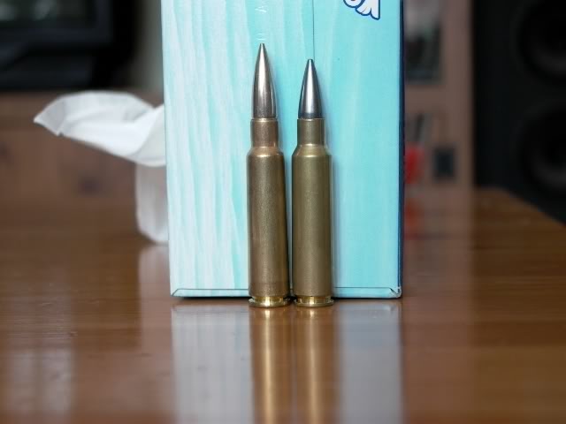

For my K31 I actually shoot 150gr Hornady FMJ, they are pretty much match bullets, I use Varget and 308 Win loads for 2650fps. Never bothered with anything else in the Swiss as these shoot really good. I also use 284 Win brass as when I started loading there was no 7.5x55 brass around. I'm not sure how many times I've loaded these (neck sized) but at least 8 times now.
GP11 on the left, 284 neck sized on the right with 150gr Hornady FMJ. They have short headspace, but wide chambers cases blow out quite a bit. Using 308 Win data is safe and keeps pressures nice as low, at least with the midrange speed powders based on the case volumes. I wouldn't run too slow or too fast of a powder in these, mid range stiff works well
