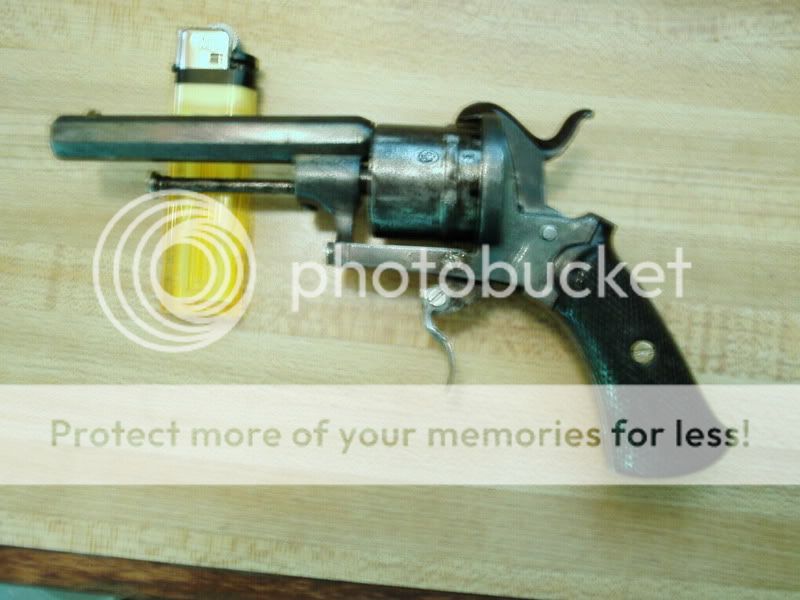

david doyle said:
I feel a pinfire coming on!
Here's a bit of eye candy to help you along the way :>) :>) It was made in Denmark by Christensen and has 4 pin locks of the highest quality.
cheers mooncoon
