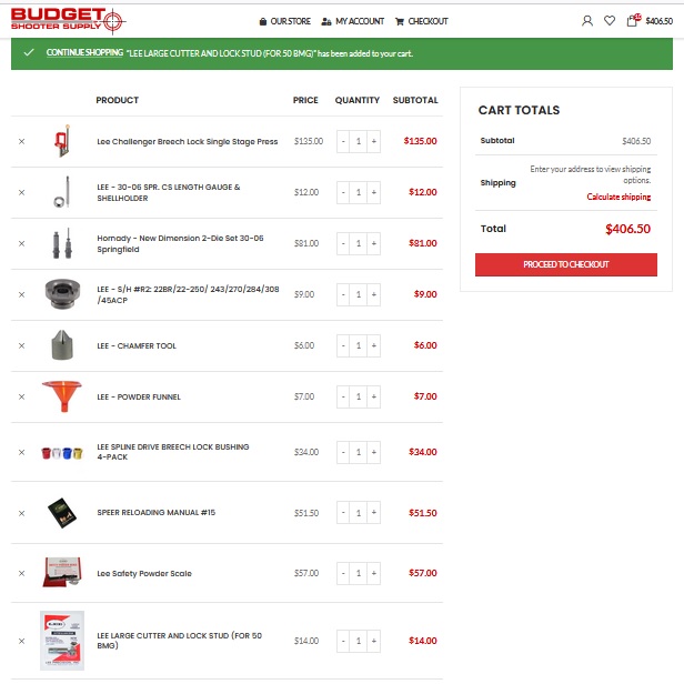

At a minimum, you will need a press, dies and shellholder, powder scale, case trimmer, and a few small accessories like a case block, powder funnel, and loading manual. I just built a shopping list on Budget Shooter Supply and it came to $407 before tax and shipping, though that includes a Lee powder scale, and just about everybody agrees a better scale should be had.
For components, each cartridge is going to cost you about $1.20 with a run-of-the-mill hunting bullet like a Speer Hot-Cor or Hornady Interlock. The big issue is going to be finding primers. The supply chain was stressed in 2020 and has not recovered. They should be 5 cents each, with multiple brands available, but right now you will pay 20-30 cents each, if you can find anything. Hopefully this won't last much longer, a year ago all primers were in short supply, now only the large rifle are still a problem to find (though all are still too much money).
