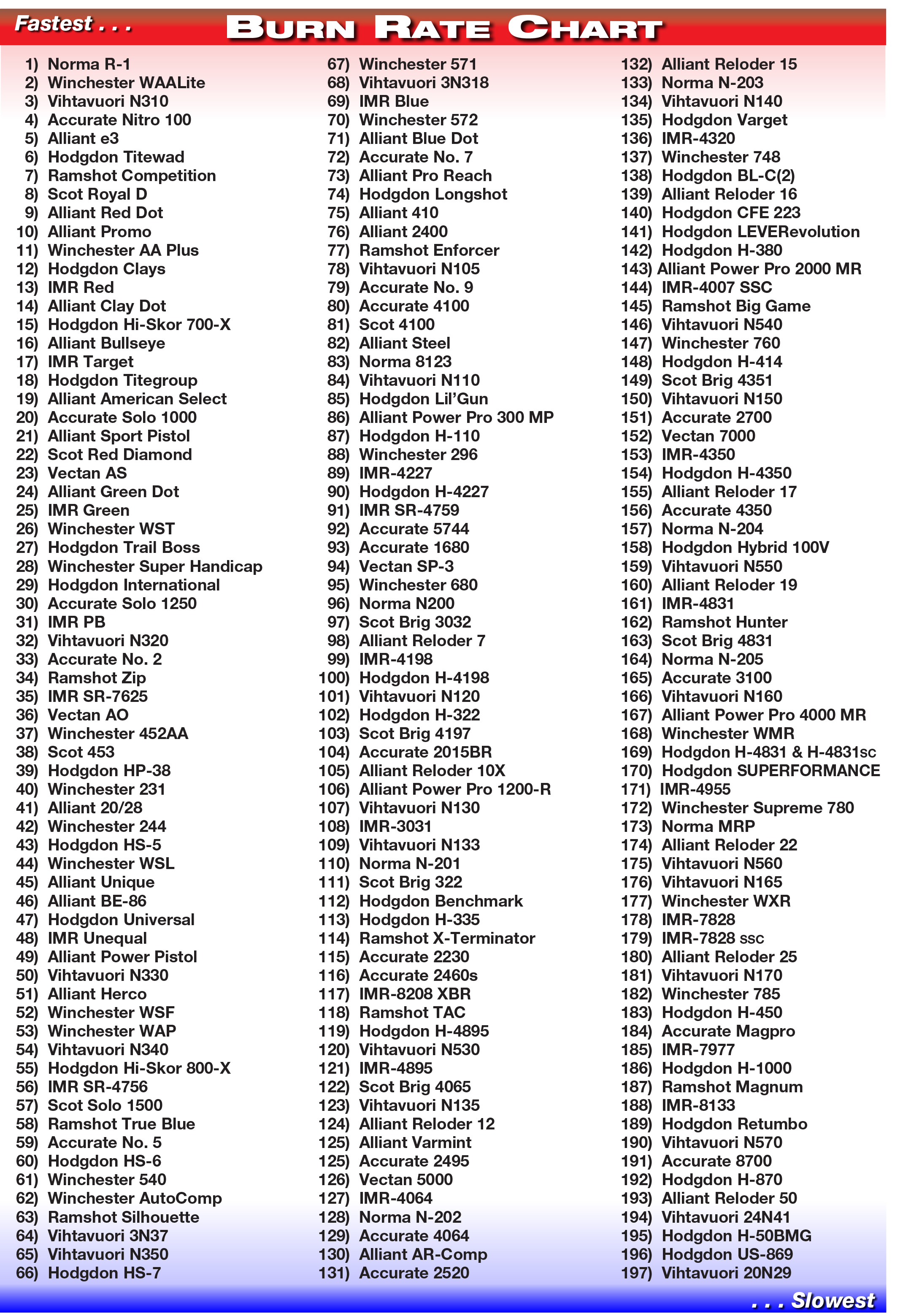

there are lots of questions about swapping powders
that's a bad idea as recipies are there for a reason
however if you can't find a powder you are after, you can use a burn rate chart to discover similar powders that may have receipies
I STRESS POWDERS SHOULDNT BE SWAPPED / INTERCHANGED
however there might be loads you are not aware of
we are working to have the best selection and prices available
So if times were really hurting and you need a medium burn powder could you take fast burn and buff it down with a slow burn powder and make what you need.
I have a similar chart but what it doesn't tell you is the actual burn rates, meaning the degree to which one powder burns in relation to another. I'm considering smokeless in my modern 45-120 and know that a slower powder is better. People recommend 4895 and 5744 but they are in the middle range so wouldn't retumbo or h-50bmg be better suited?
No. Never. Different densities will separate in the case; in the powder measure, in the can with handling. Uneven burn rates = pressure spikes..

Be careful with substituting to achieve ballistics ! Yes you can but, going by a burn rate chart for instance is just the very "first" step in load development, I have been loading and casting since the 70s, I use "gallery loads" (reduced loads) for cost effectiveness and also experimented with "like " burnt rates to test (such as Leverevolution in place of CFE223 and varget for instance) to get maximum fps.
Position sensitive powders, reduced powder capacity, too slow a powder for case volume just to name a few...you can have a bad day if your primer flame jumps your reduced powder charge and burns from both ends or ,too slow a powder in a large case full and the primer only pushes the projectile into the rifling, now you have an obstruction and with a hang fire !you can guess what that would do!
