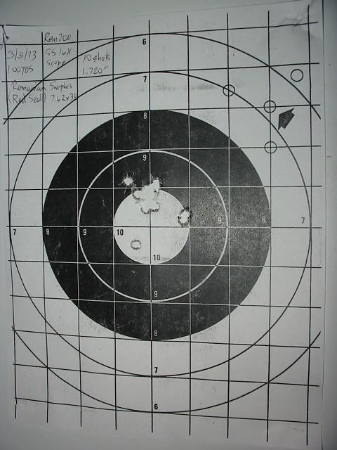

This rifle is capable of putting ten rounds of surplus under 2 MOA. That barrel pictured is an older .308 Win varmint barrel I cut and rechambered and has over 4,000 rounds of 7.62x39 surplus through it when I shot the group pictured.
