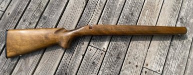

My 788 carbine in 7mm-08, acquired ~ 30 yrs ago, came with a well used dog of a factory stock. I replaced it with a vintage Ramline synthetic [back when they came with a Pachmayr decelerator recoil pad installed] and it shot so well just as it dropped in I never did anything further with it. That bad factory stock went sideways along the way, probably in a house move.
Awhile back was able to score another factory stock off the EE for it, if I ever decide to put it back into 'wood'.

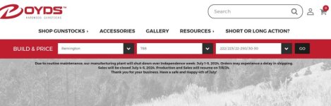

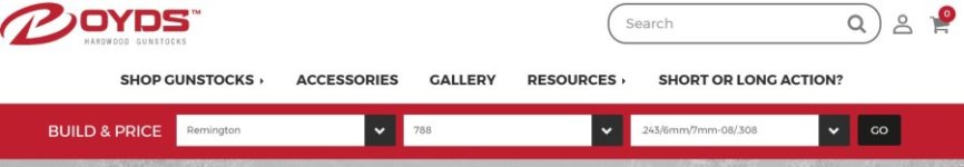

Boyds has the caliber attached to the stock at the bottom of the page.
Choose your caliber in the customization menu.
Pay close, very close attention to the distance between the action screws
