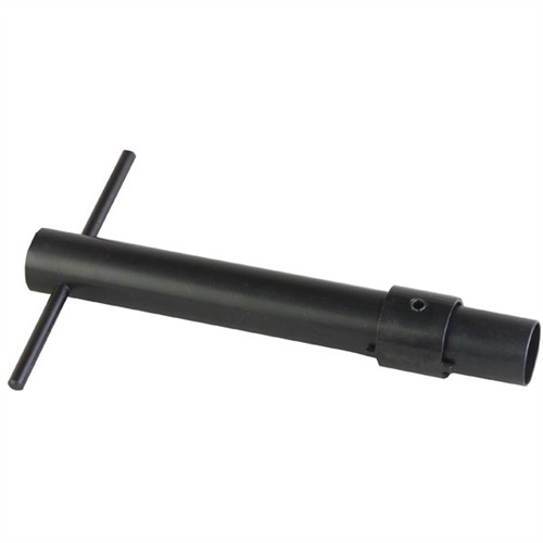

I recommend this:
REMINGTON/MOSSBERG FOREND WRENCH
* Mfr:BROWNELLS
* Piloted To Prevent Stock Or Nut Damage
Wrench adapted from Remington factory design, with pilot that keeps “teeth” square to the forend nut, virtually eliminating damage to wrench, forend or forend nut. But, if one of the wrench teeth should ever break, turn the “sleeve” around, there’s another set. Models for Rem. 870 or Mossberg 500.
Catalog page 436, 437
http://www.brownells.com/.aspx/pid=968/Product/REMINGTON_MOSSBERG_FOREND_WRENCH
