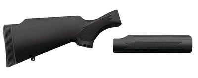

Do any of you guys know where I could get a synthetic Monte Carlo stock(no need for the forend) for the Rem 870?

If you want one JUST like the one pictured, I have one..
It's meant for the 2X" Fully rifled barrel, with rifle sights.
PM me.
It would be for my Rem870 Express super mag. I use it mostly for trap shooting. Do you guys think it could give me a disadvantage using it for trap?
Look like exactly like this

It'll probably help you. Most 870 field guns shoot very flat. The MC stock will most likely cause you to see more rib and which in turn will cause the gun to shoot high...that is generally what you want for trap. You'll now have to hold under the target a little but at least that target while always be in good view.
